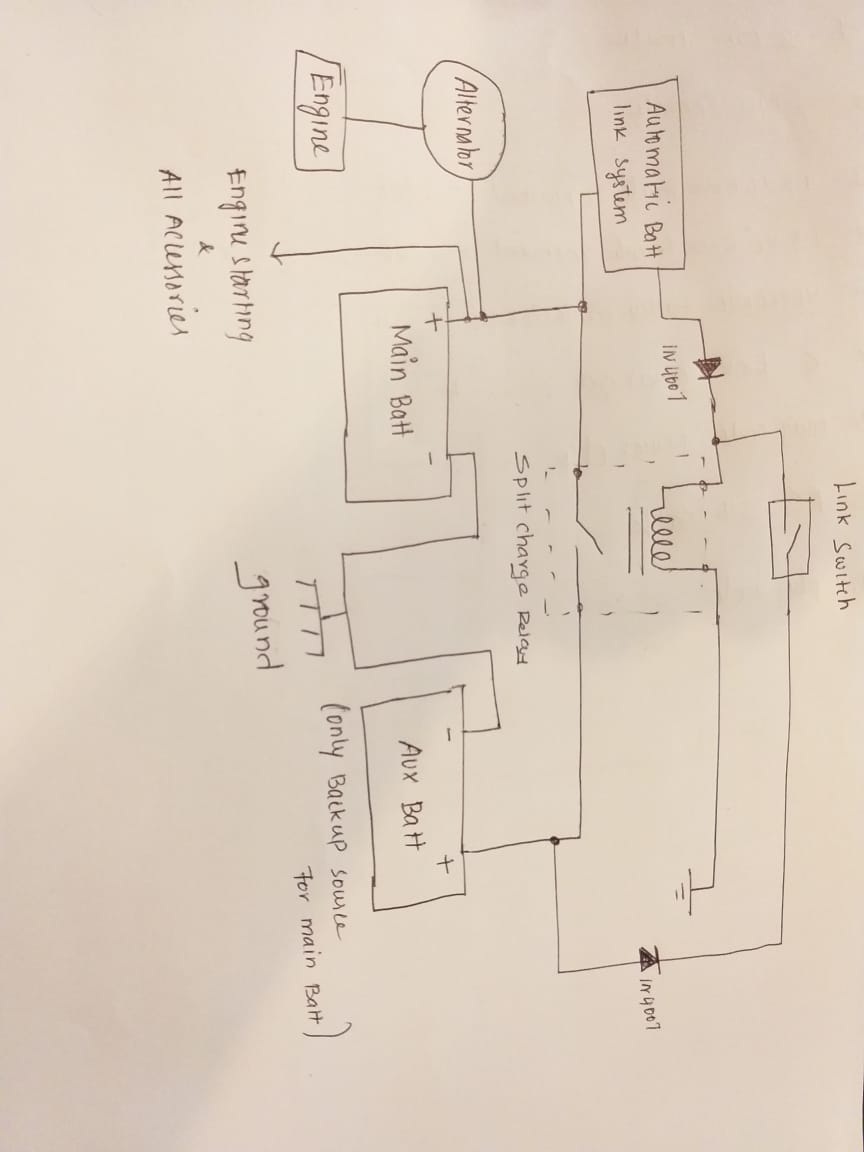

I want to design the circuit board for the Automatic main battery and auxiliary battery link to charge when the engine is running. with your supports.
When the engine is running, the alternator provides power for charging the main battery. Auxiliary battery backup support, when the main battery is dead, the main battery can be started by the manual link switch to start the engine. The alternator is generated at a voltage of 13.7V to over 15V. the main battery powers all accessories
Automatic battery link system:
The automatic battery link system will monitor the main battery. Once the main battery reaches 13.7V or more, the system should link the main and auxiliary batteries, which means that the engine is running. The main battery voltage is lower than 13.7V, the system will automatically cut off the power, which means that the engine is off.
I have attached the split charge system layout for your reference. I hope it can be better understood better.
Thank you for your assistance.

Your circuit diagram is a bit odd. I think that in principle it's OK, but the two rectangles that are the batteries should just be interconnections. Each battery should have its negative permanently connected to ground.
There are a lot of systems that will do what you want already.
Depending on what this is fitted to, the alternator may change its voltage depending on conditions. A lot of modern cars do that.

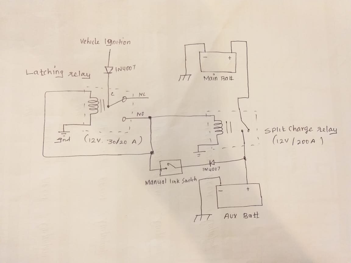

Please find the attached Split charge system layout which is currently used.
The main & aux batteries are linked to charge When pressing the link switch- the engine is running condition.(Batteries continue to charging,until the engine is turned off, even after release the link switch).
When the engine is running, press the switch for the battery linked to charge every time.

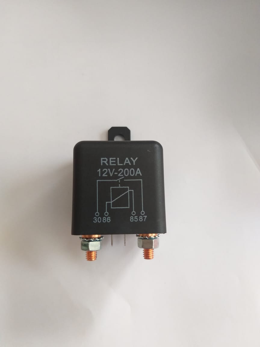

Is that 12V, 200A relay continuous duty?

My systems are not to be connected in parallel. The relay is used to separate both batteries. I need to be connected in order to charge both batteries when the engine is running and to detach both batteries when the engine is turned off.
Actually, my configuration isn't connected automatically. I need to press the link switch to connect the batteries, which will then be automatically isolated when the engine is turned off ( this condition is fine).
So I'll need your help to create a circuit, and once the engine is running, the circuit can send power to the relay coil(the circuit sense the voltage level and the relay will link the batteries for charging).

Why not just power the relay from the ignition switch accessory power circuit, which is off when the engine is starting, but active when the ignition is on?

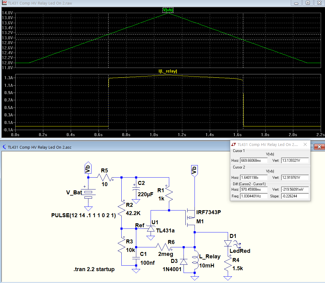

I'm looking for a voltage sensitive circuit schematic that input will be connected to the main battery And I need the 12V/1A output voltage for relay coil energized, once the main battery has reached 13.V or higher(engine is running).
Below is the LTspice simulation of a circuit that uses the common TL431 programmable shunt reference as an accurate comparator to turn on the relay when the voltage is above the set point.
The TL431 conducts and turns on the P-MOSFET when the Ref voltage provided by the voltage divider R2-R3 from the battery voltage (Vb) goes above 2.5V.
An increase or decrease in R2 will increase or decrease the trip voltage (here shown as Vb ≈ 13.1V for the given values).
R2 can be a 50kΩ pot if you want the trip voltage to be readily adjustable.
R6 provides some hysteresis so the relay doesn't chatter around the set point, causing the relay to drop out at about 0.27V below the upper set point or Vb ≈ 12.9V here.
The LED D1 provides an indication that the relay is energized.
The transistor can be just about any standard (not logic-level type) P-MOSFET with a ≥50V and and Rds(on) of ≤0.5Ω rating.
The circuit can be built on a small perf board.
