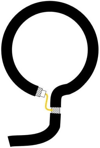

First, find where the noise is coming from.
My first thought is that it does not come from a linear regulator.
Could be coming down the mains wiring from who knows what, who knows where.
It look like some of the crud which comes out of the control system for my CNC milling machine.
Useful information. I will do some more checking keeping this in mind and revert.
I have no doubt you will see a 10 x reduction on noise with the method I outlined.
You can get maybe a 100x improvement on noise by using a good cap near supply in series with 50 Ohm coax soldered within 1cm of source and a 50 Ohm terminator at scope in x1 mode.
You can use a shorted loop as an antenna to find the noise source, usually switching power supply or a brush type motor. etc, either conducted via ground or radiated..
I am attaching noise across a 12V battery, across 1ft wire, when holding the same wire with hand, when probe pin shorted with probe ground.
From this can we conclude that this is a radiated noise? How can it be eliminated/ reduced?

It appears to be noise measurement error from radiated noise. THe probe loop must be very small and if you want to try good coax shorted to ground with 50 Ohm termination, then you can improve measurement methods as I outlined before..
Ok. There may be errors in the noise level measured. What could be the source for such radiated noise. What could be the implication of such noise pick ups.
As I said before, impossible to tell your situation. But using a shorted ground clip to probe tip use this loop as antenna to locate source. if you can
Such as SMPS, motor brush arc etc. Conducted noise on cables becomes a radiating noise source like antenna.

Personally I believe you're wasting your time, that kind of noise it perfectly acceptable.
Although, generally you should measure using 20Mhz bandwidth limitting on your scope. Also, with noise that low, your test setup needs to be spot on, so I'm not even convinced the noise is even there in the first place!
It is a common mode noise error showing up on a differential measurement from poor ground loop in probe.
With clip removed and no ground wire just using the pin and barrel of the probe, right at the PSU output terminals or test pins with a small cap., you should see acceptable quiet results.
Sometimes two probes are needed when the common mode noise is very high, or high quality coax with 50 Ohm load. ( AC coupled). Other times the twin probe method needs both probe cables twisted together for very fast rise time noise pulses.
