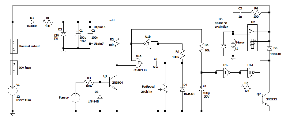

Now my question : I want an electronic circuit switching a 12 V relais on and off at a set speed. E.g. at 40 km/h the relais should be switched off, below 40 it should switch on. I should be able to preset the switching point at higher speeds too. I think of applying a hall-sensor on the shaft going to the frontwheel. The pulses from this sensor should be used to count and trigger a relais via a transistor. The circuit in between shall handle the pulses from the hall-sensor and should include a regulator so that I can preset the relais switching at a defined speed of the car.

Here's a suggested circuit, with a pot to adjust the cutout speed. Almost any inductive sensor (automotive type) should work with this.
U1 is a quad Schmitt trigger NAND gate IC. Each sensor pulse triggers a monostable circuit comprising U1a,U1b. The monostable output pulse width is set by C3 and the pot. The output pulses are integrated by R5,C4 and the result, if high enough, trips U1c and U1d to turn on Q2 and energise the relay. D5,C5,R6 are to suppress motor switch-off voltage spikes and may need to be tweaked.
Q1 could be the open-collector output of a Hall sensor if that were your sensor choice (R3 and D3 would then be omitted).
If you want a manual over-ride for this circuit, a SP3T On-Off-On switch could be connected to Q2 to provide On, Auto and Off functions.
I've attached the LTspice simulation file.

The circuit would be quite compact if built on stripboard, with heavier gauge conductors for the motor switching contacts of the relay. The relay will need to have contacts rated somewhat higher than the DC current the fan motor draws.
D5 is a Schottky diode which needs to have a current rating approaching the normal motor current. The suggested one is 10A rated, but can take the occasional peak of 30A or more.
Be aware that the IC is static-sensitive.

I see btw that 40 km/h means 36 Hz pulses. How high can the potmeter drive the pulses ? Thnks
It should allow for pulse rates at least double that 36Hz and somewhat below that. If you need a wider range then C3 and R5 could be changed.
BTW, if your sensor output is not high enough then R3 could be reduced in value to, say, 10k (it's not critical).

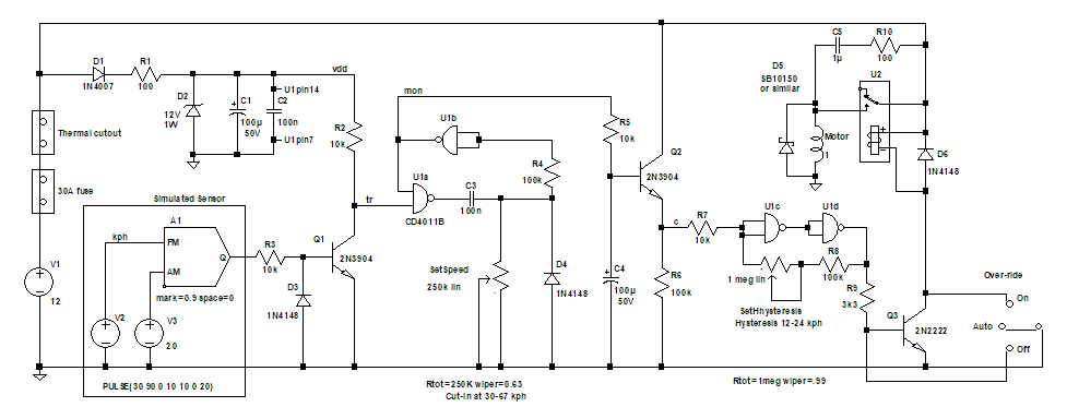

I was thinking about a kind of delay for trafic jam driving or city traffic where the cars drive between 40 and 60 km/h. Because of the quick changes in speed, the fan would start and stop frequently. A delay of 60 seconds before shut off would overcome the quick switching. Is that feasable ? Many thanks again.
Is that feasable ?
Not without a major change to the circuit. But the manual over-ride would be simple: just an added switch.

On running the sim again I found the hysteresis inherent in the CD4093 was excessive (the motor would switch on but not off unless the road speed was very high), so I've revised the circuit. The IC is now a CD4011B and U1c,d have been reconfigured as a Schmitt trigger with adjustable hysteresis. The SetSpeed pot should now allow the motor to turn on over a range of 30-67 kph. The SetHysteresis pot gives a 12 - 24 kph hysteresis. This means, near the minimum settings of both pots for example, the motor should turn on at 30kph and turn off at 42 kph.
Given the hysteresis, I don't see why any 60s timer would be needed.
Note: C2 has been increased to 100n. Q2 buffers the voltage on C4.

Oh yes, so much better !!! Also the addition of the override switch is a great help . Thanks. The introducing of the missing symbols failed. Its the first time I see a program like this, so I need some learning time to grab it. But I believe the outcome of your simulation, you'r the experienced one. The hysteresis-setting is indeed a better solution then a time delay. I now even can set to fan to start at 30 km/h and by another setting to stop at 90 km/h, super !
