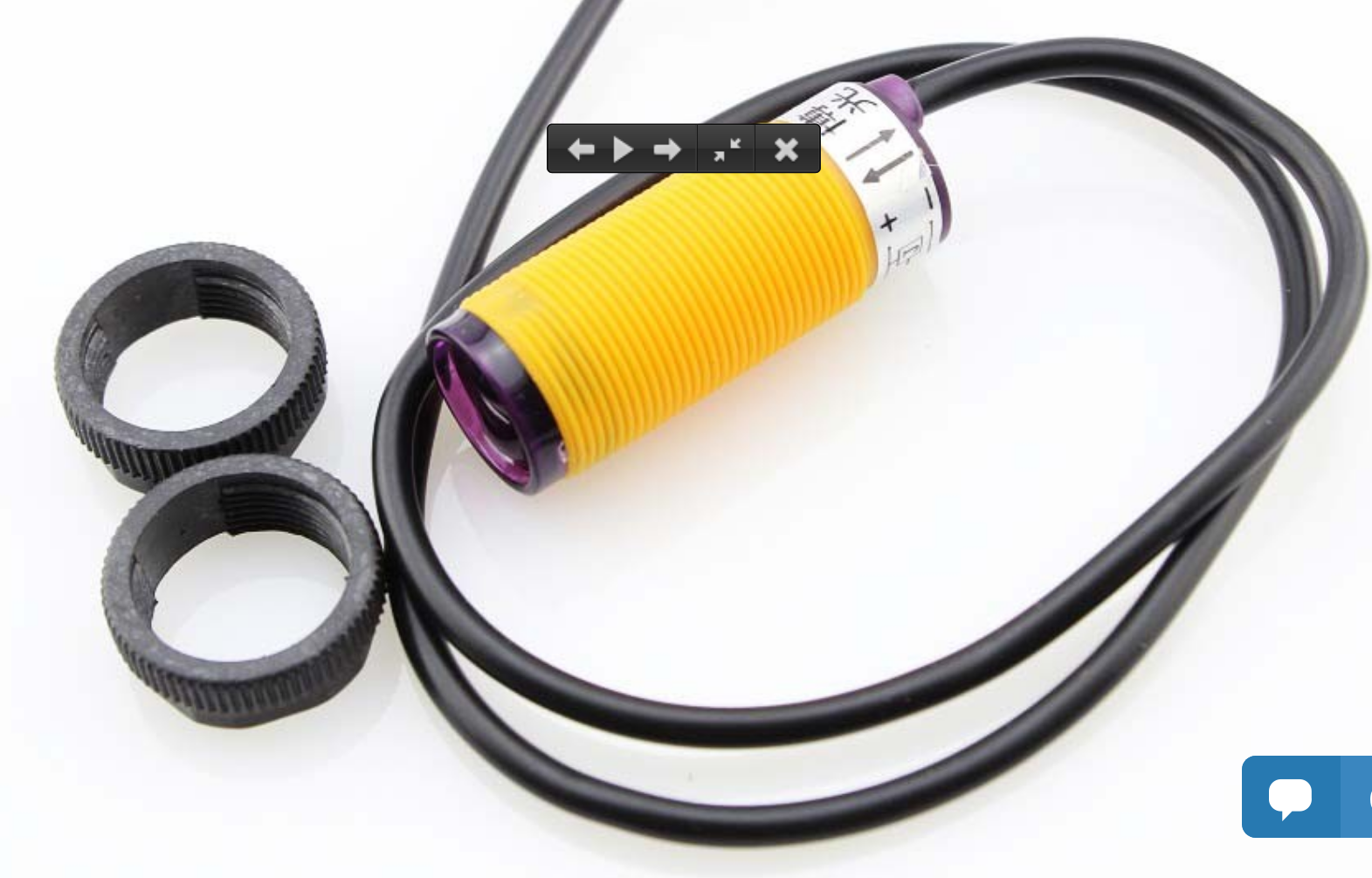

An easy way to measure speed would be an IR optical sensor like this one from Elecrow Electronics. This type of sensor will generate a pulse each time a piece of reflective tape passes in front of it. The detection range between tape and sensor is a few cm to half a meter.
These sensors are commonly used to measure the speed of rotation for machinery.

Jonsea, Thank you. I also found many other types of this IR sensor on google. I guess what remains is trying to program it together with a micro-controller
Thanks Dr Pepper. That link will actually help because my design already includes PID tuning, even though am using matlab to design the circuit specifications and some op amps for building the circuit. If the PID circuit works then, I will try to incorporate it with a micro-controller. Am not yet sure how that will work. And for the speed sensor, I suggested a photo-transistor (that will measure how many times the light is blocked by the spinner in a second), which i am not sure will work fine. I intend to replace it with an IR optical sensor as suggested by JonSea.
