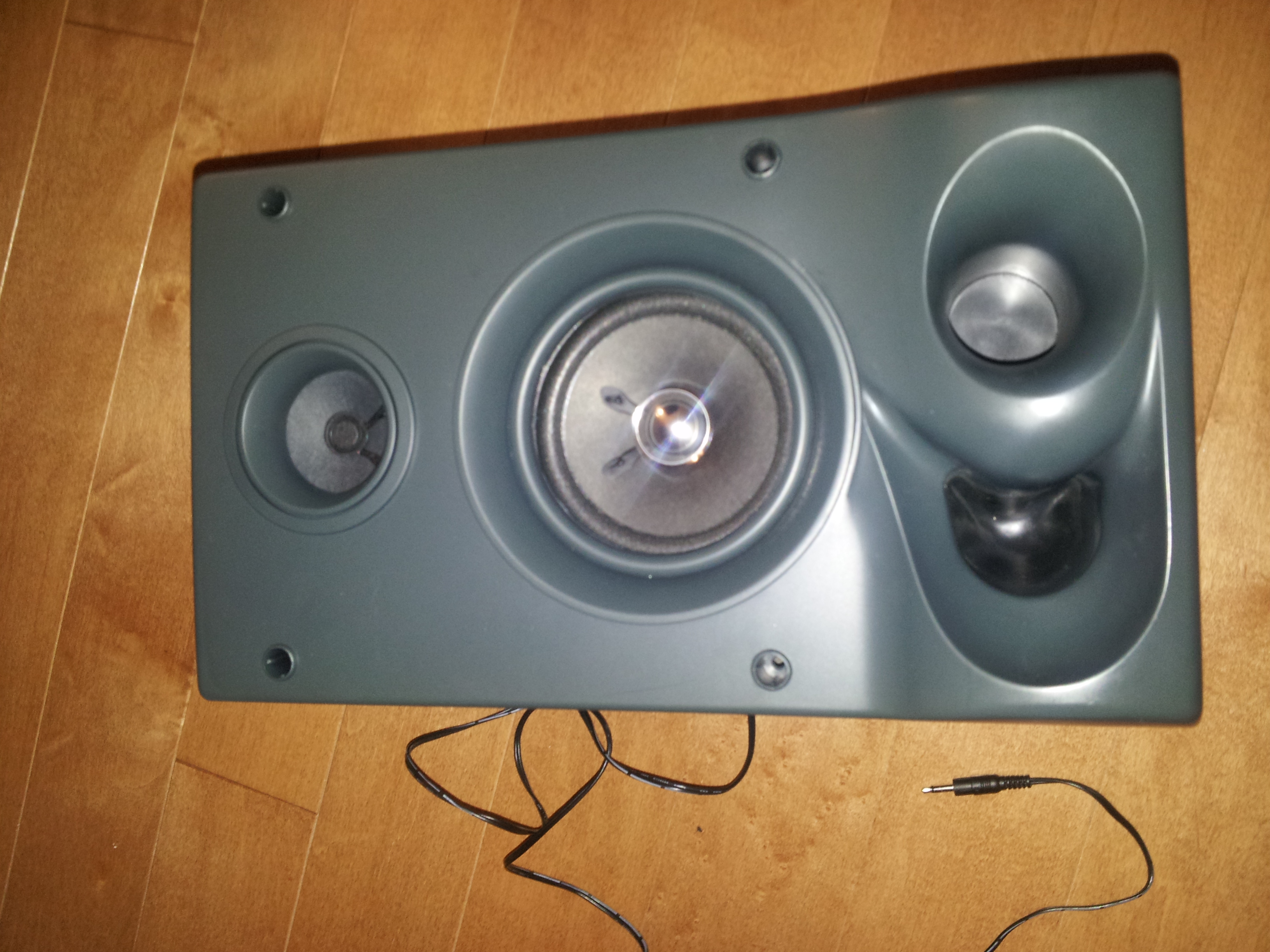

I dont know if this is the right site to post this question, but i have a speaker made up of a tweeter and a mid to low speaker.
I measured the ohmage of the speaker with a multimeter, and got around 4.3Ω. I want to find out its wattage. is there a way of finding out its wattage from the impedance only? like running different powers to find out its RMS?
I cannot open it in any way, and i do not have its brand. Here's a picture... could we estimate it from the size of the speakers?

No, there is no way to tell, unless you´re willing to test the speaker until it breaks.
Wattage rating means how much power you can put into it without the speaker melting, so there really is no way to simply judge this. Maybe you can guess by looking at its size an year of make and comparing it to others.
My guess is about 20W.
It appears to be a low power cheap speaker. To find out its power handling then you will probably destroy it.
Its woofer in the center is probably only 4" or 5" at 2W to 5W.
Its tweeter on the left is probably 2" at 1W.
I do not know what the things on the right side are.

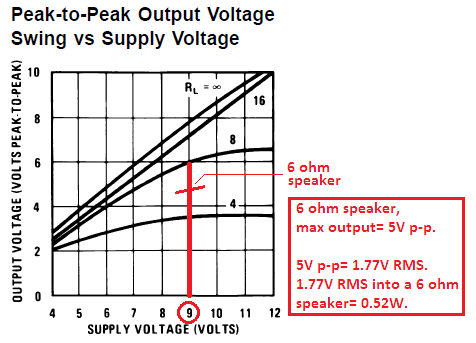

Why don't you look at the graph of P-P Output Voltage Swing vs supply voltage vs speaker impedance on the datasheet like I did?
The LM386 works best with a 9V supply. There are lines for a 4 ohm speaker and for an 8 ohm speaker. 6 ohms is halfway between them.
The amplifier output when it begins to clip is only 0.52W even if the speaker is rated at 500W!
A 500W speaker is rated to survive 500W but can still play only 0.52W.
Other graphs on the datasheet show the heating of the amplifier.
Speakers don't "pull" power from an amplifier. Amplifiers provide as much power as they can if the volume is turned up.
