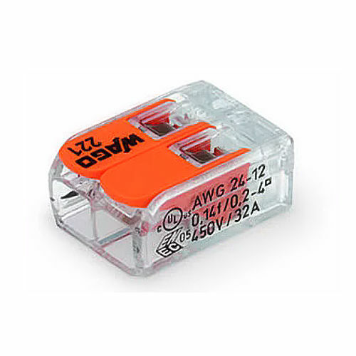

If you do not want to solder, I suggest you get some Wago 221 or similar lever-operated cage clamp terminals.
Just strip the insulation from a wire for the correct length, open the lever, put the wire end in and close the lever. They form an extremely reliable connection.
All the sections are electrically connected in these, so two of the two position type can be used for joining the wires - one for the reds and one for the blacks.

I think I will start with a couple of WAGO 221s so I don't have to solder.

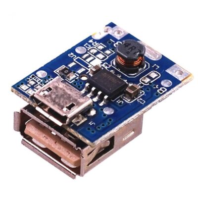

You could connect the battery in place of the battery in a power bank, as the electronics in a power bank have the charge control circuitry. However, usually due to the way they are made, you would still need to solder wires.
Or use a power bank module like this - but again, it needs soldering..
Edit - missed the link.
