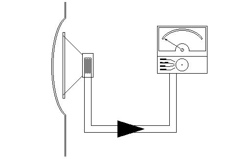

I think that using the speaker as a sensor is the way
to go here.
How about a single transistor amp feeding a meter,
then give the front of the speaker cover a flick with
something to see which way the meter jumps ...
Its something that has been an annoyance in the past,
but i haven't thought about it till now.
Something simple to indicate the 'phase' of a speaker
would deserve a box of its own in my collection.
I might see about doing that.
John :)
A small speaker in a box with , say, a 555 timer and a fat FET to produce a single pulse of maybe 20 or 30 milliseconds. This will produce a single pressure pulse. The distance between this and the speaker under test will not affect the polarity of the pulse, only its strength and time of arrival.
All we need now is something to determine the direction of the first edge of the electrical pulse from the speaker under test. Op-amp, couple of comparators, dual d-type flipflop and a quad nand gate ought to do it.
I have yet to try this,
but it doesn't look difficult,
i reckon a little whack with a newspaper
should be enough to make the meter jump.
Simple enough to swap wires,
and see if it jumps the other way.
Probably will need a bit of amplifying,
i'll see how it goes.
Regards, John :)

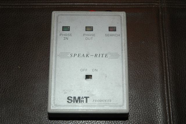

Just to let you know I own such a device you are speaking of, I also install car audio and have used it for years it works great, I did a Google search for it and I could not locate it. It's called speak-rite by Smart products. It works with a green led and a red led and has a mic at the top for detection. It has a red and black leads (probes) to test the wire and a rca hookup also.........I've owned this item before the internet was born.........well about 25 years ago...David
