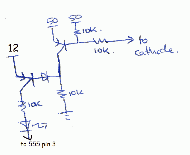

I thought the circuit you gave will be variable from 0-10 amps? You mean that the circuit can only output 50VDC @ 3amps?
With the resistor values shown, it should work from 0-3.5A. You can increase the current range by decreasing the 330K resistor.
The reason I said 3A is because that was your example in one of your earlier posts and that your PSU is only 5A. Anyway, if your electrode is carrying X amps with a spark occurring, how is that different from it carrying X amps with a short-circuit? (in relation to destroying the anode)
Yes, the ON time arc through the dielectric does also munch away the anode eventually but not as bad as a dead short. It turns red hot and "poof". I suppose experience sometimes defies all laws :-) . Secondly, I will want to eventually use 15 amps. What value do I have to increase the resistor to, and which ones? Do I also have to replace the mosfets with a higher range? Finally, could you please redraw the circuit including the tacked in opto. I hate to be a pest, but you are the only one here offering help -which is greatly appreciated , I assure you.
How do you plan to get 15A 500ms pulses from your 5A PSU?
Real big caps? :)

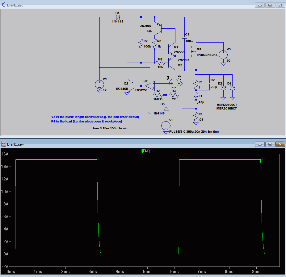

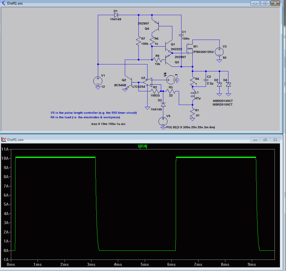

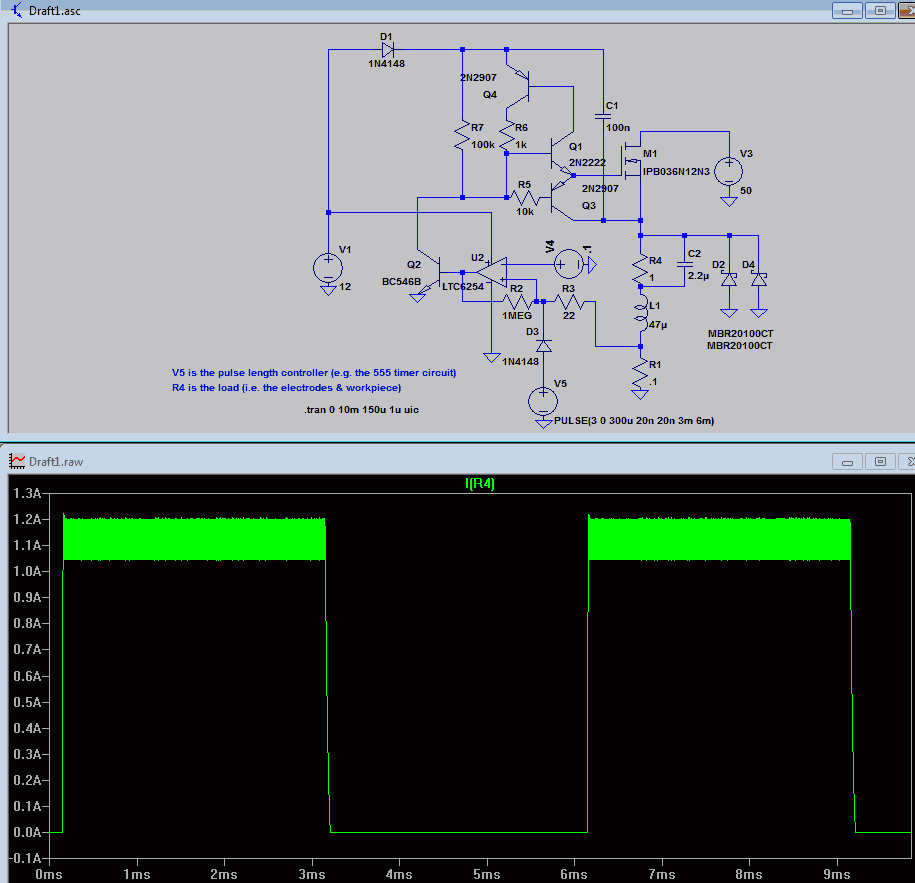

Here's the chopper version if you're interested. It doesn't have any of the heating (or self-destruction) issues that the linear version has, the downside being the small amount of ripple current (more noticeable for low current settings).
Attached images show the circuit and the current waveform for 1A, 10A and 15A settings.
