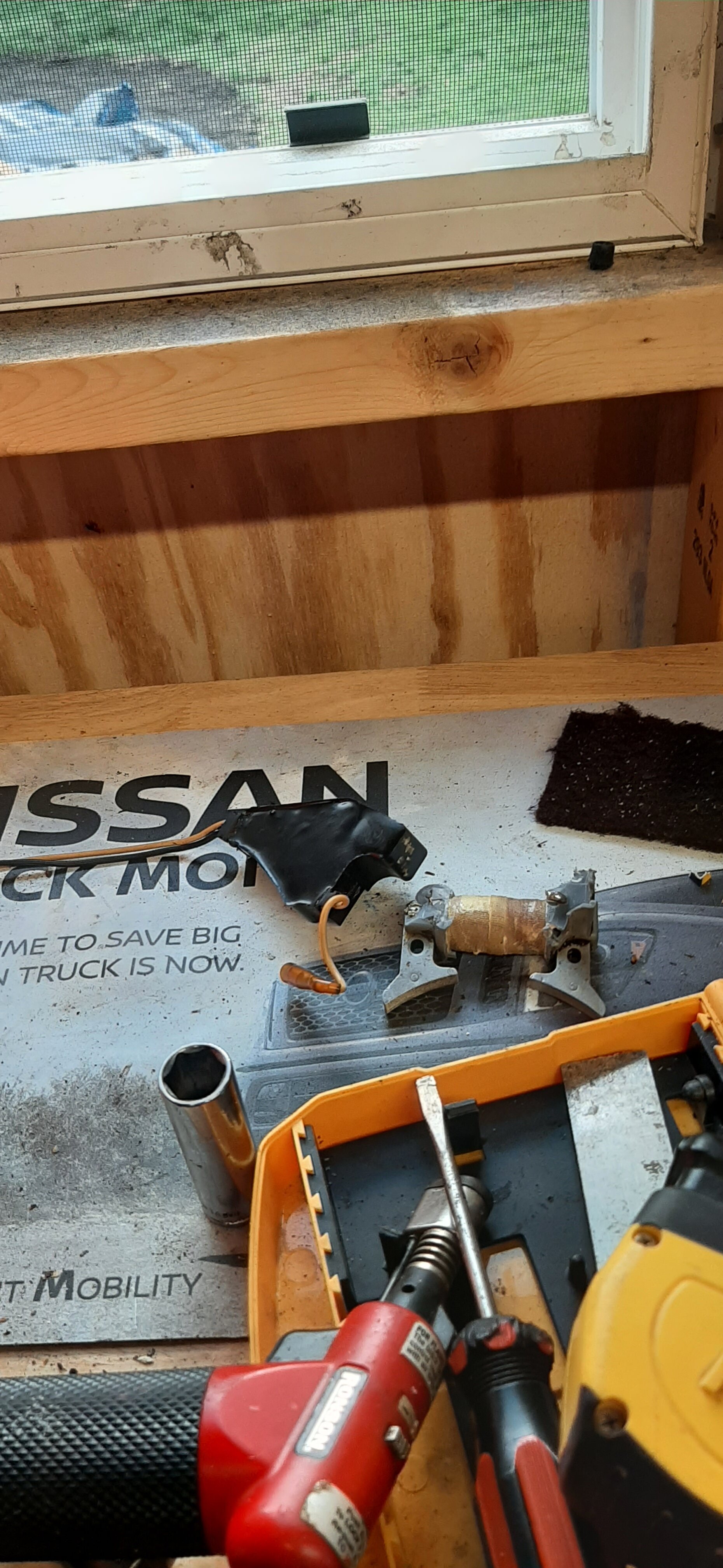

Hello, i have an echo 610evl chainsaw, its a twin cylinder chainsaw utilizing two coils and one pickup coil, the pickup coil has a cdi box to automaticaly advance the spark. My question is can i delete the cdi box rewind the pickup and wire it in? If so would i rewind the pickup in the standard way? Idk how it was, the pickup and cdi were potted together in epoxy

Thank you for the explination that makes a lot of sense, I still have the cdi box it wasnt damaged when i seperated the coil, in theory i could free it from the holding material using acetone, repair any open solder joints and rewire everything back together? I have seen youtube videos where they repair the cdi box, and ones where fhey rewind source coils. Ill post pictures of the contraption later today.

Every story helps one way or another:) im sure its the pickup coil/cdi unit as i swapped it out from another saw just to be sure.
They are nowhere to be found and its a common problem for these saws unfortunately, being a rare twin cylinder saw itd be cool to get a repair procedure or something out there
