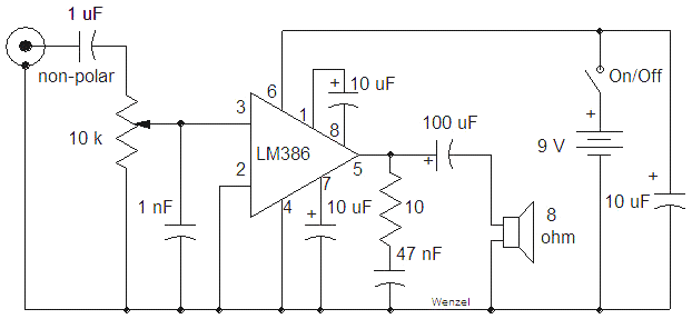

And i found this circuit digram on some website.will it also work if my input is an electret microphone?..i mean is this jsust power amplifier or power amplifier with preamp too?.im sorry i dont have any knowledge about this unless i try all this out thats why may be this is silly question:|

and whats the theory behind the two variable resistors in the circuits i mean one in the preamp circuit and one in the power amplifier.i know one of them definately controls the volum but which one and what does the other do?
The power amp one is an attenuator, a standard volume control.
The one in the preamp sets the gain of the preamp, to match your specific mike and how much gain you want.
