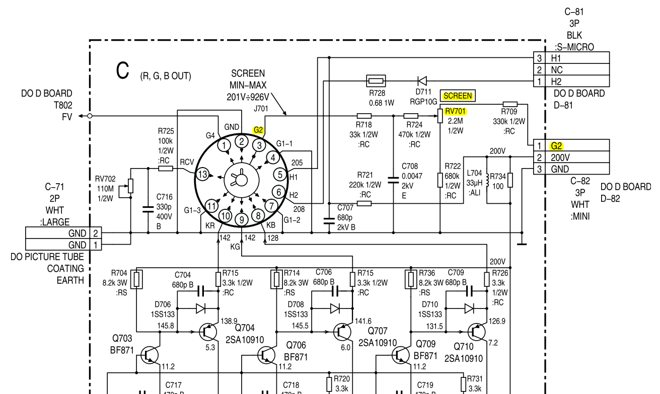

Do you mean G2 as showed in the attachment?
I will check also R522 (100k) with the +B.
By the way, warming power supply running in stand-by around 8 hours had not better result.
Yes, the one labelled G2 - you might also check the voltages on the cathodes of the CRT - pins 8, 9 and 10. These will be affected by adjusting the G2 control.
In common with any relatively 'modern' set it has automatic grey scale, so as the CRT wears out it automatically turns itself UP - resulting in lower cathode voltages, until it's outside of it's adjustment rangem, when it then shuts down. By turning the G2 control up, this gives it more space to adjust in, and often gives a short term improvement.
Check the cathodes before you adjust the G2 - they should all be fairly similar, and about 150V was usually my 'go to' voltage reading. You will probably find that one of them is particularly low, and that would be the gun that's failing.

There's not really any 'good' values, they will vary with how it's set - to make the set brighter you take the cathodes lower, or the G2 higher - so as you adjust G2 the cathodes will automatically adjust themselves, the trick is to get it within the self adjusting range. Previously the set was shutting down because it was outside the range it compensate for. The cathodes are fairly similar though, and interestingly the weakest one is green - it's usually the red gun which wears most, as it's driven harder.
The service manual gives some crap about applying an external 175V to the cathodes or something silly - I've never been able to understand that, or to get it to work.
My 'goto method' was usually (on all sets - decided on after decades of setting thousands of sets) to adjust the G2 to give about 150V on the cathodes, then if needed 'tweak' from there. 150V generally gets any set going, if it's going to work at all.

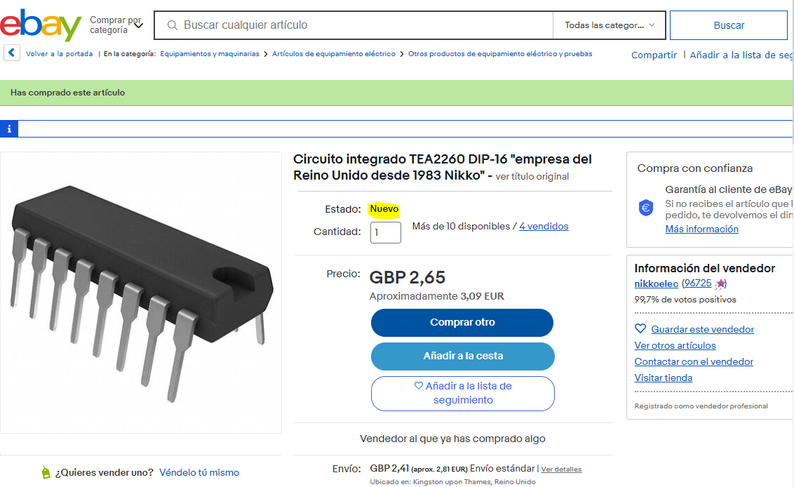

After almost one year, I found the root of the problem. It has been the IC601 TEA2260. This magnificient integrated circuit with a great design (I have been reading a lot of bibliography about it) was manufacturated with poor quality materials. This IC601 TEA2260 had been purchased from UK and installed in 2020 and their right running life has ended after barely one year. It was bought as new from here:
In fact, I did not suspect from this IC after a lot of around testings.
Now, I have replaced with a new TEA2261 (bought from local market directly in a brick and mortar store) and I will monitor the temperature performance. I have installed it with three rows of pin sockets to get it in a higher position from the main board and to enable a better air flowing by natural convection.
