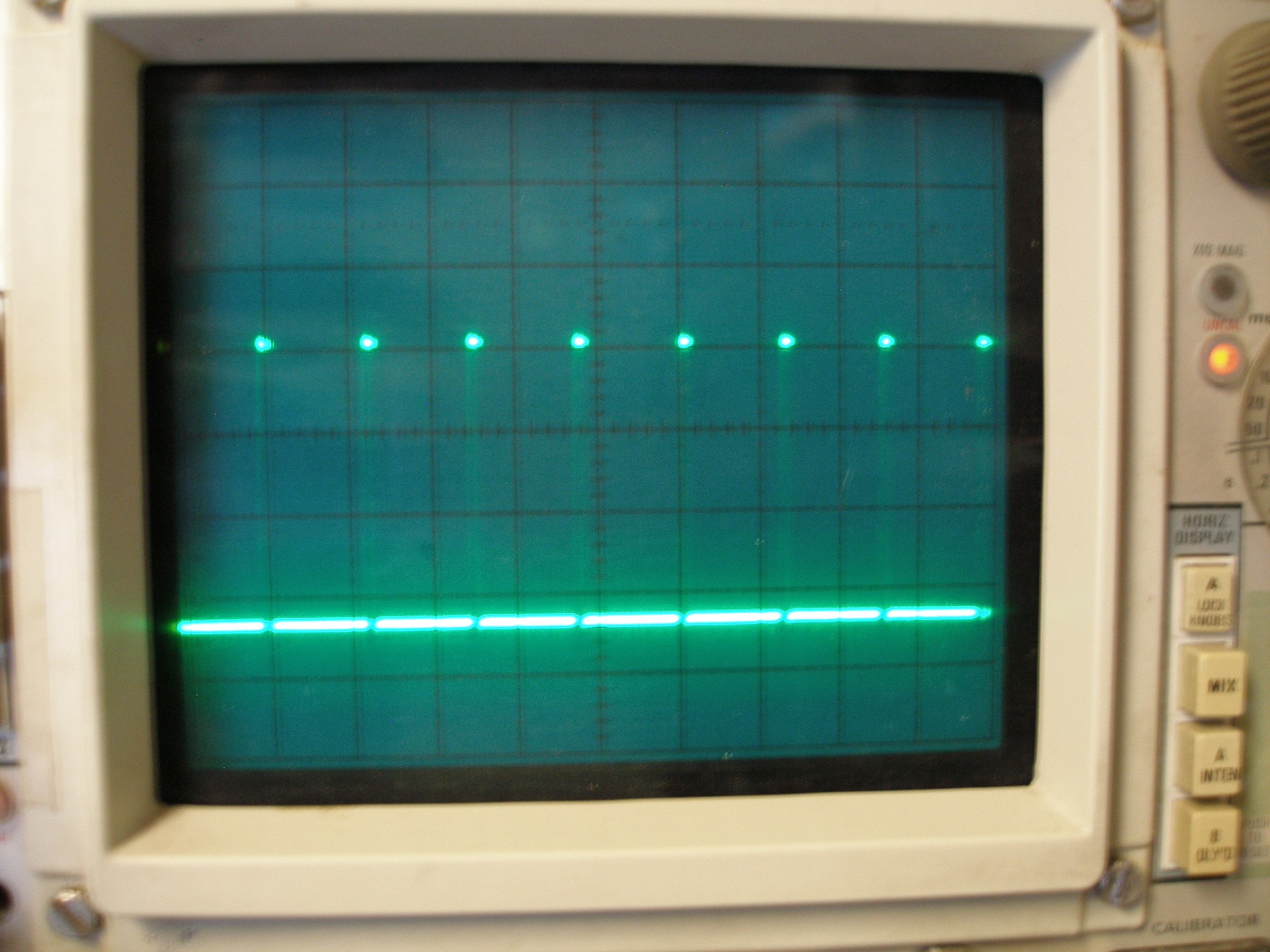

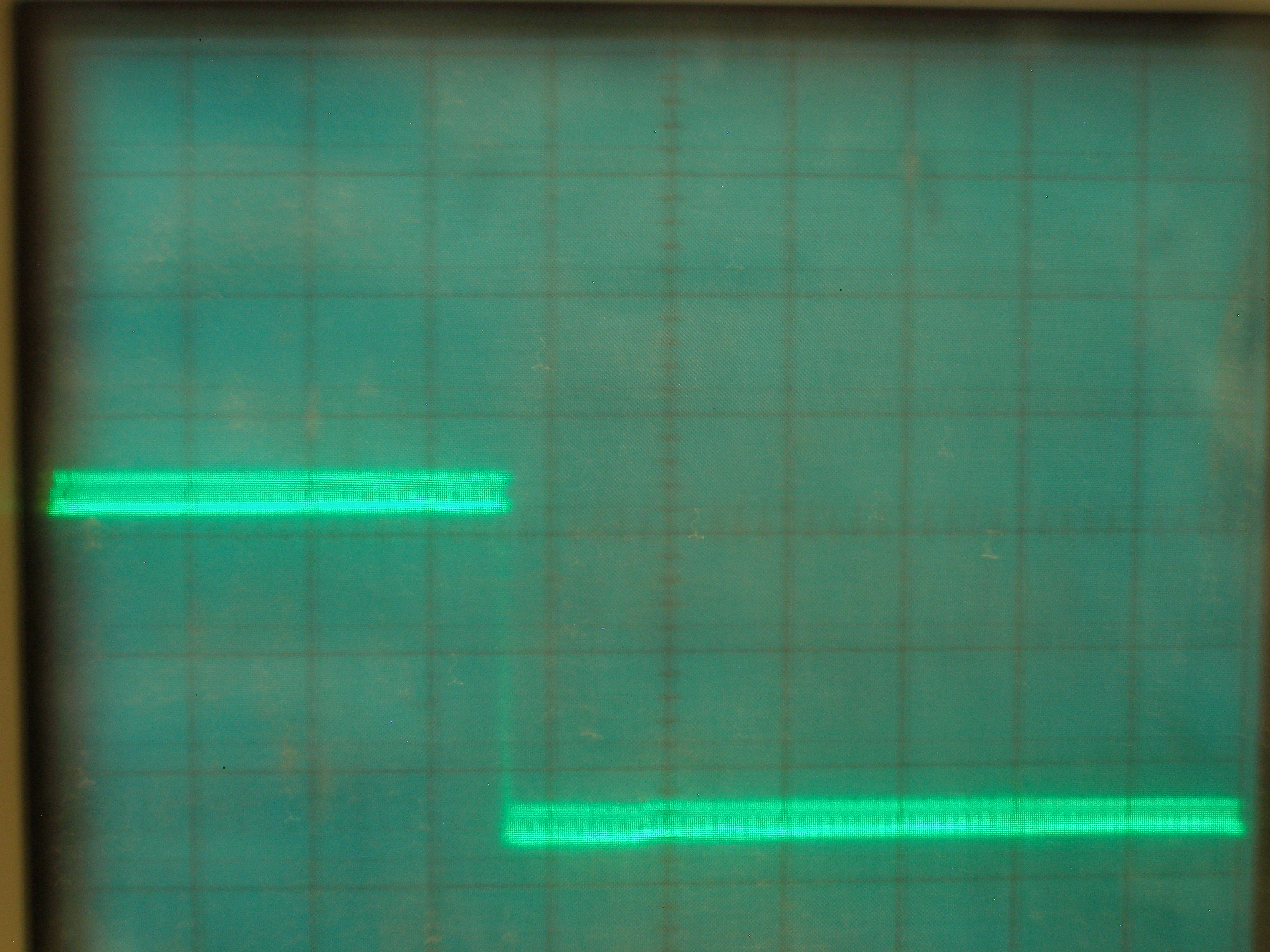

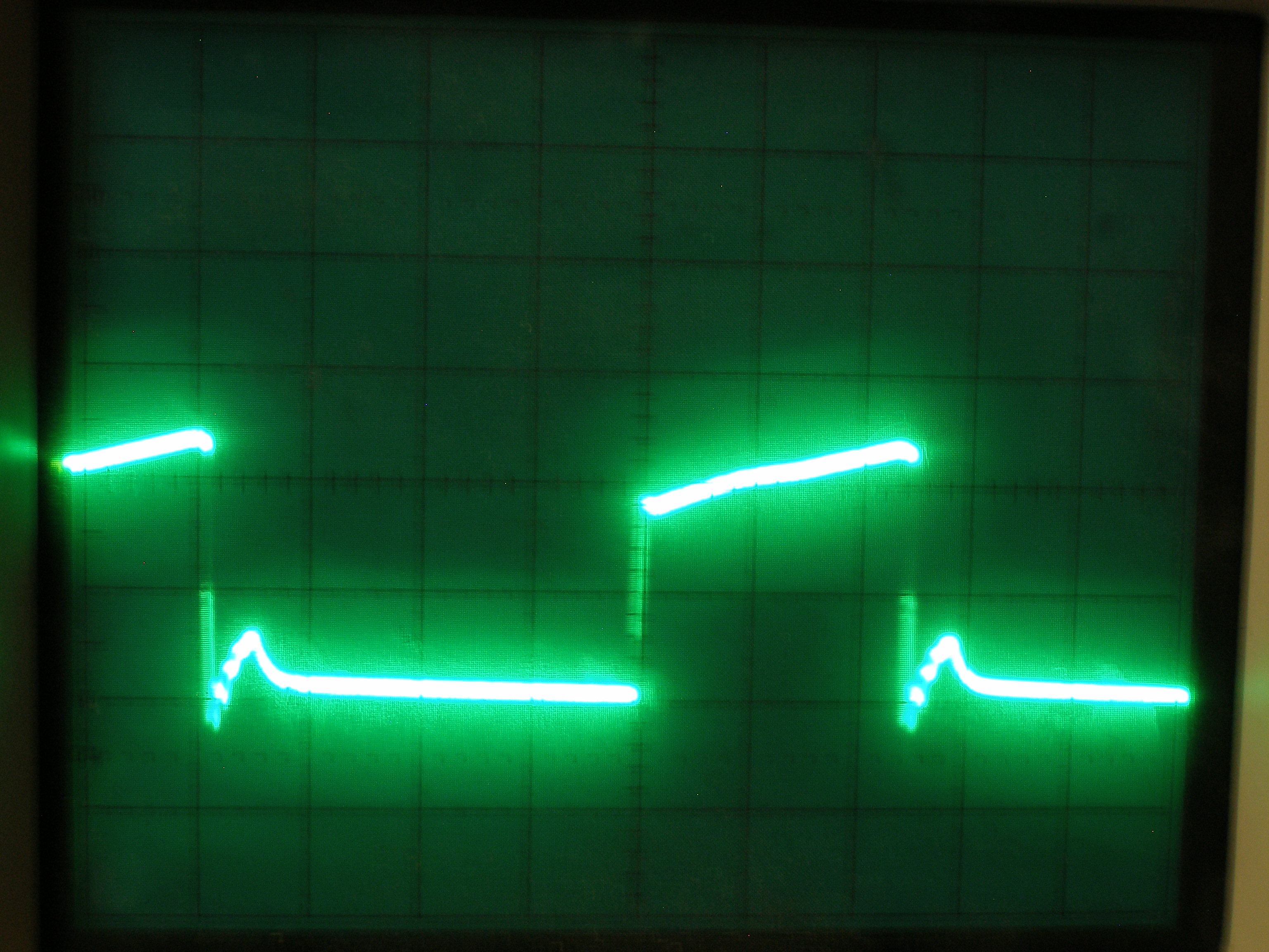

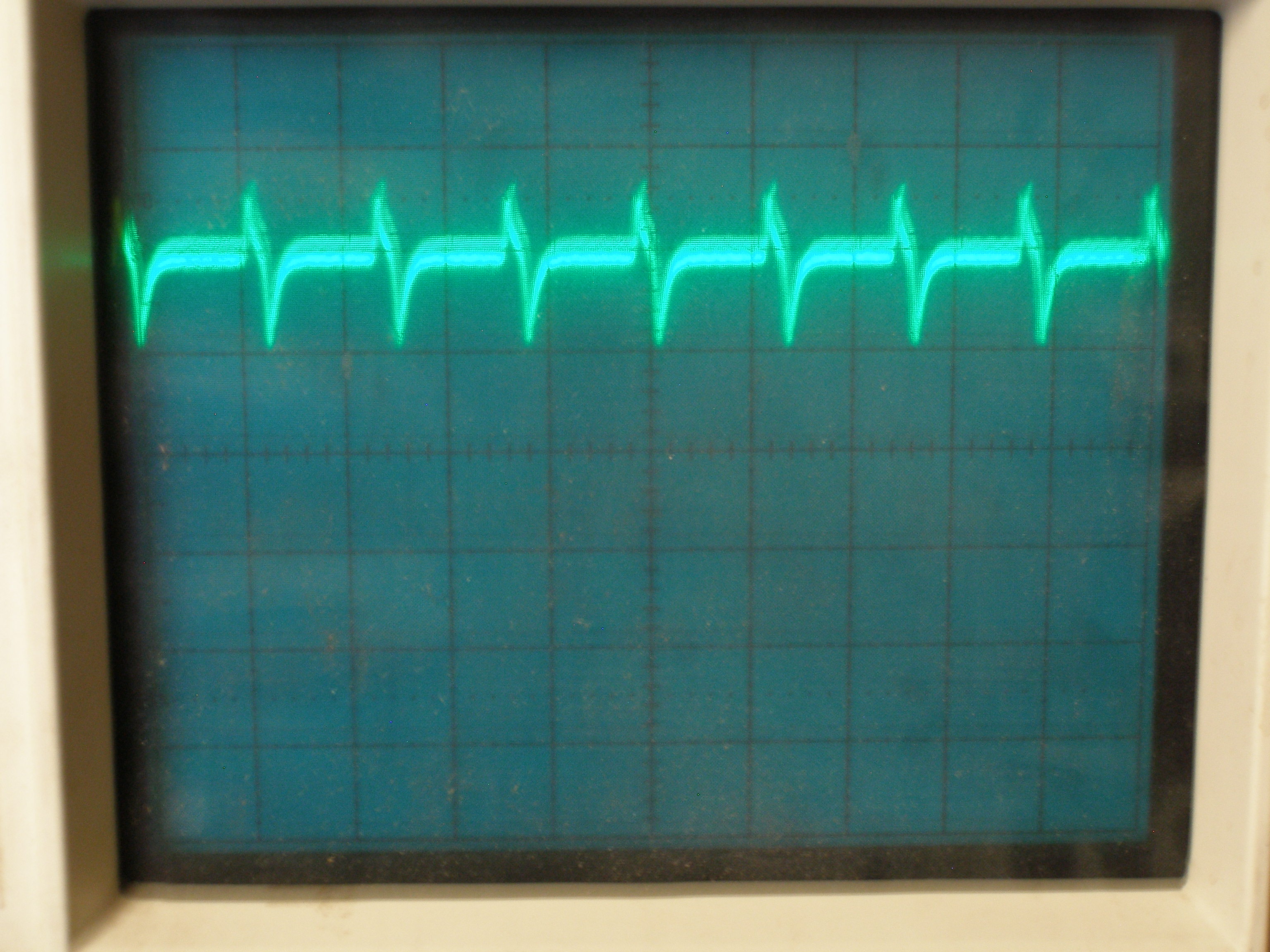

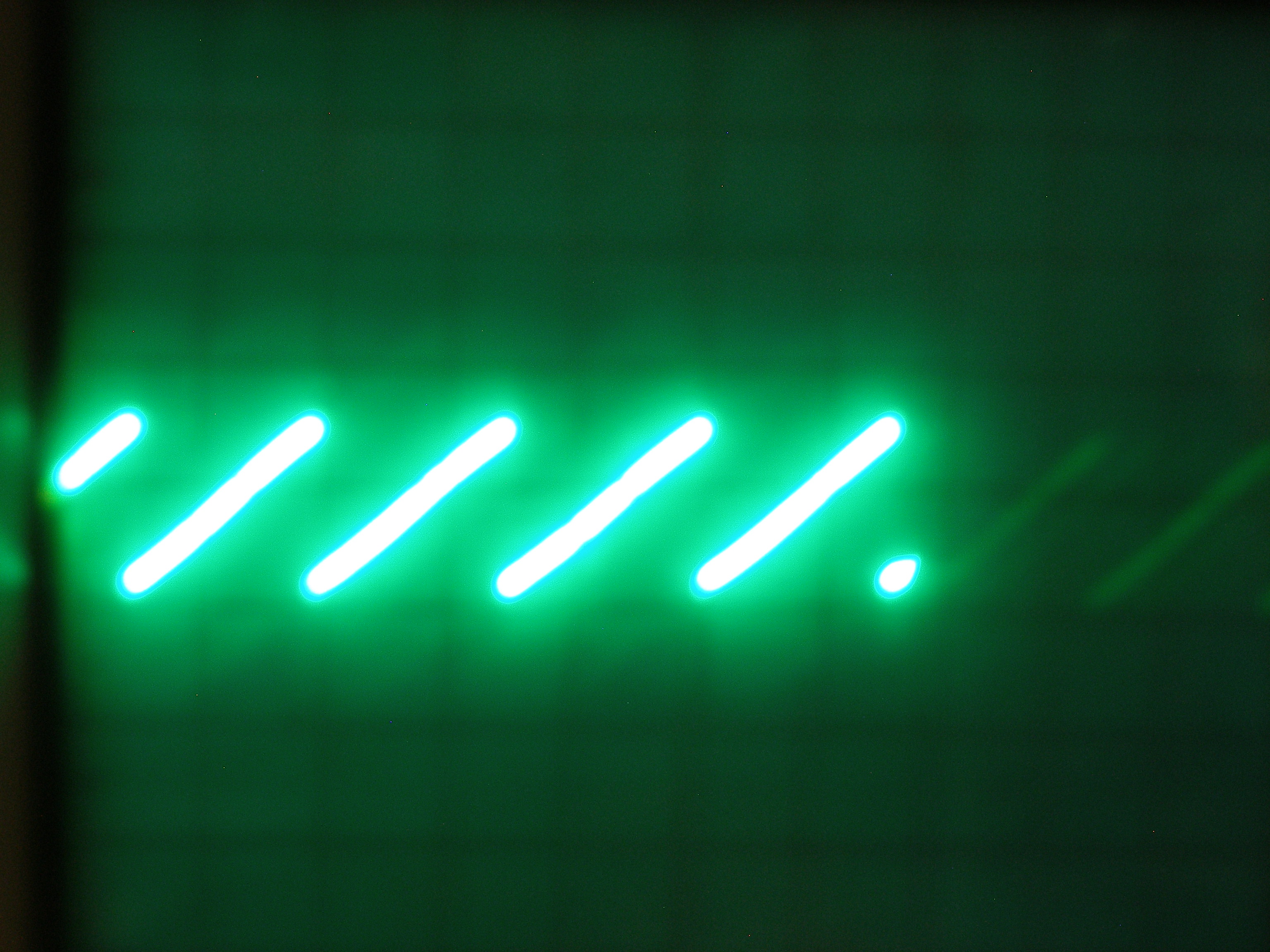

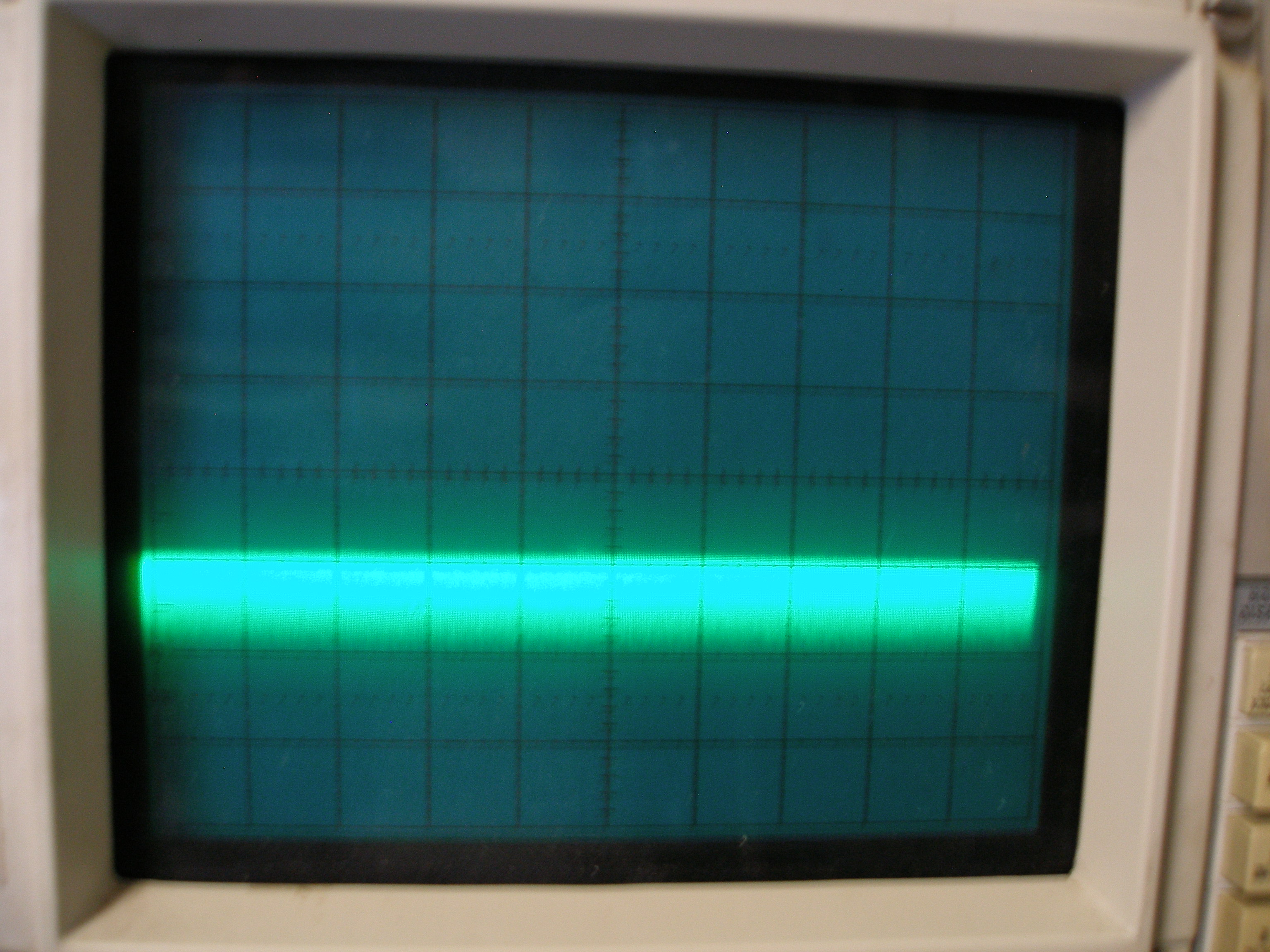

I was able to get some waveforms off of the chip and I will try to post photos as that is the only way I can think of to get something off the old scope into a digital form. Some of the patterns looked nice and clean and others not so much. Not sure what we are looking for.
You're looking for a video signal going in the chip, and the RGB drive signals coming out of it.

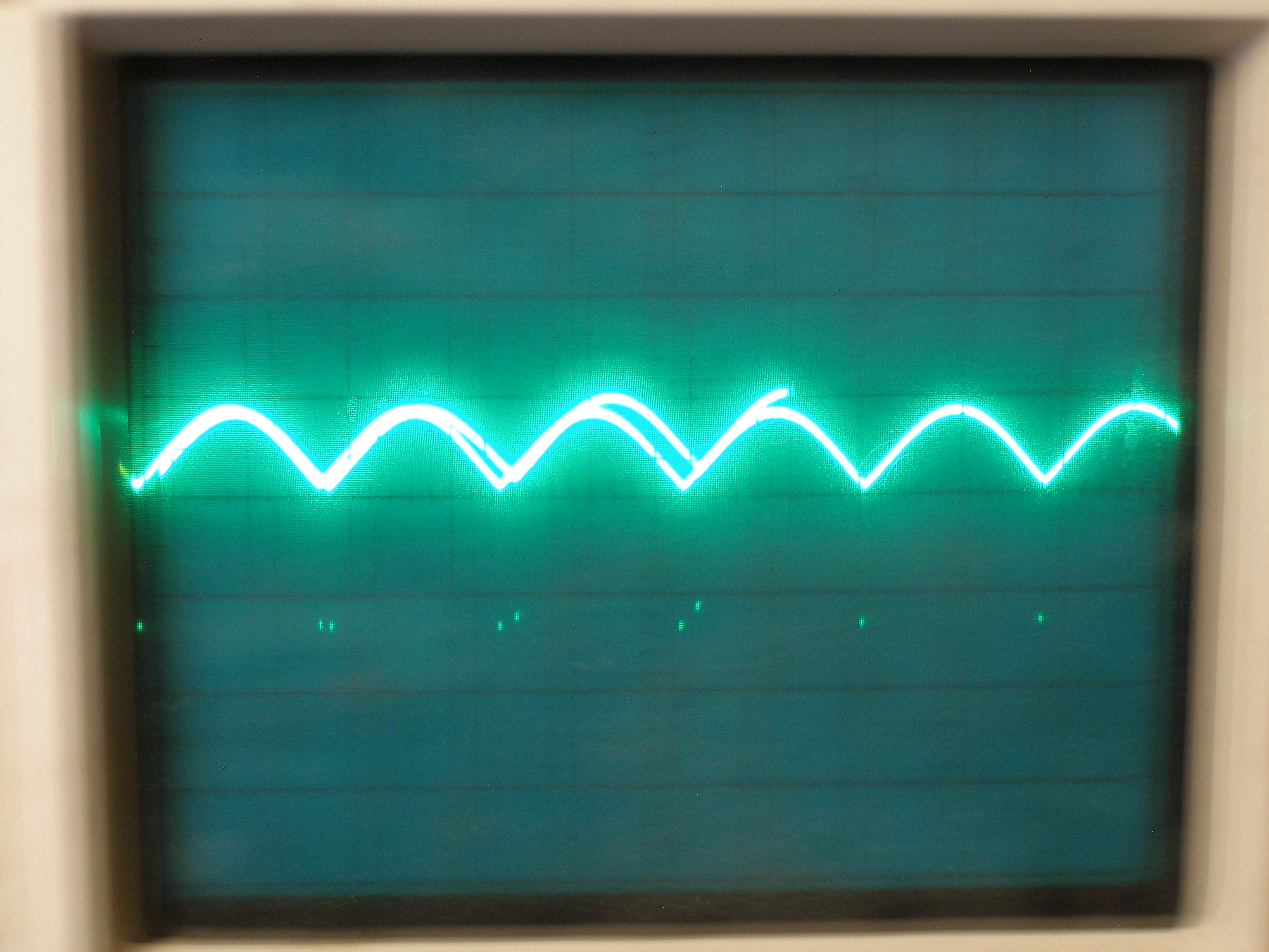

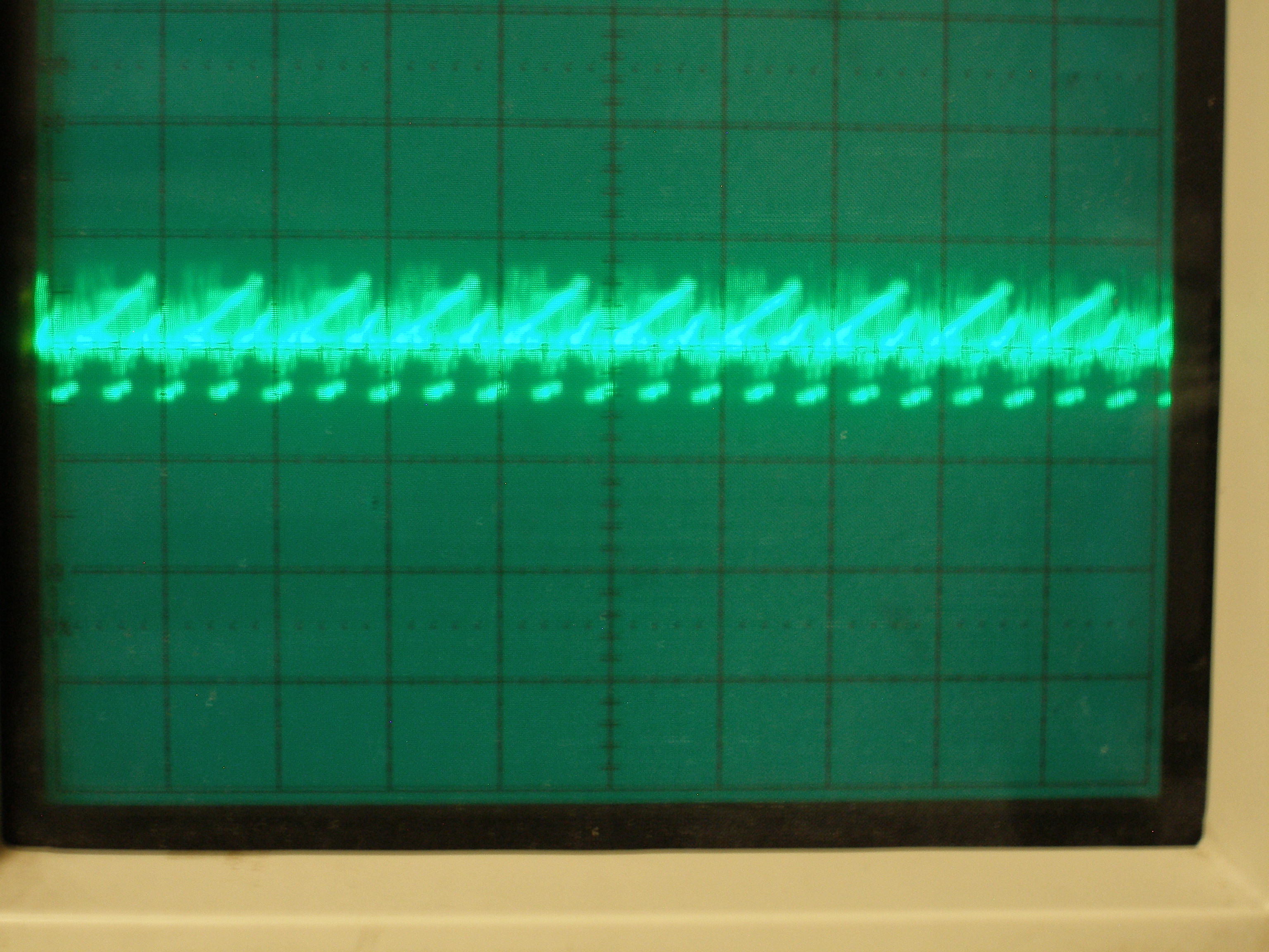

Pins 3 and 5 labled Yin and Cin is high frequency something peaking at about 4 volts. Could not get a real pattern (1st photo) pins 10 and 11 labled DBin and DG in are .4 volt straight dc pin 12 DR in is 1 volt dc. no pattern just straight line. pins 16, 17, and 18, are sort of square wave short pulses with bottom line at 2 volts and upper line at 6 volts. (2nd photo) pins 20, 22, and 24 labled R out G out and B out are sort of squre wave with upper band at .4 volts. (3rd photo)

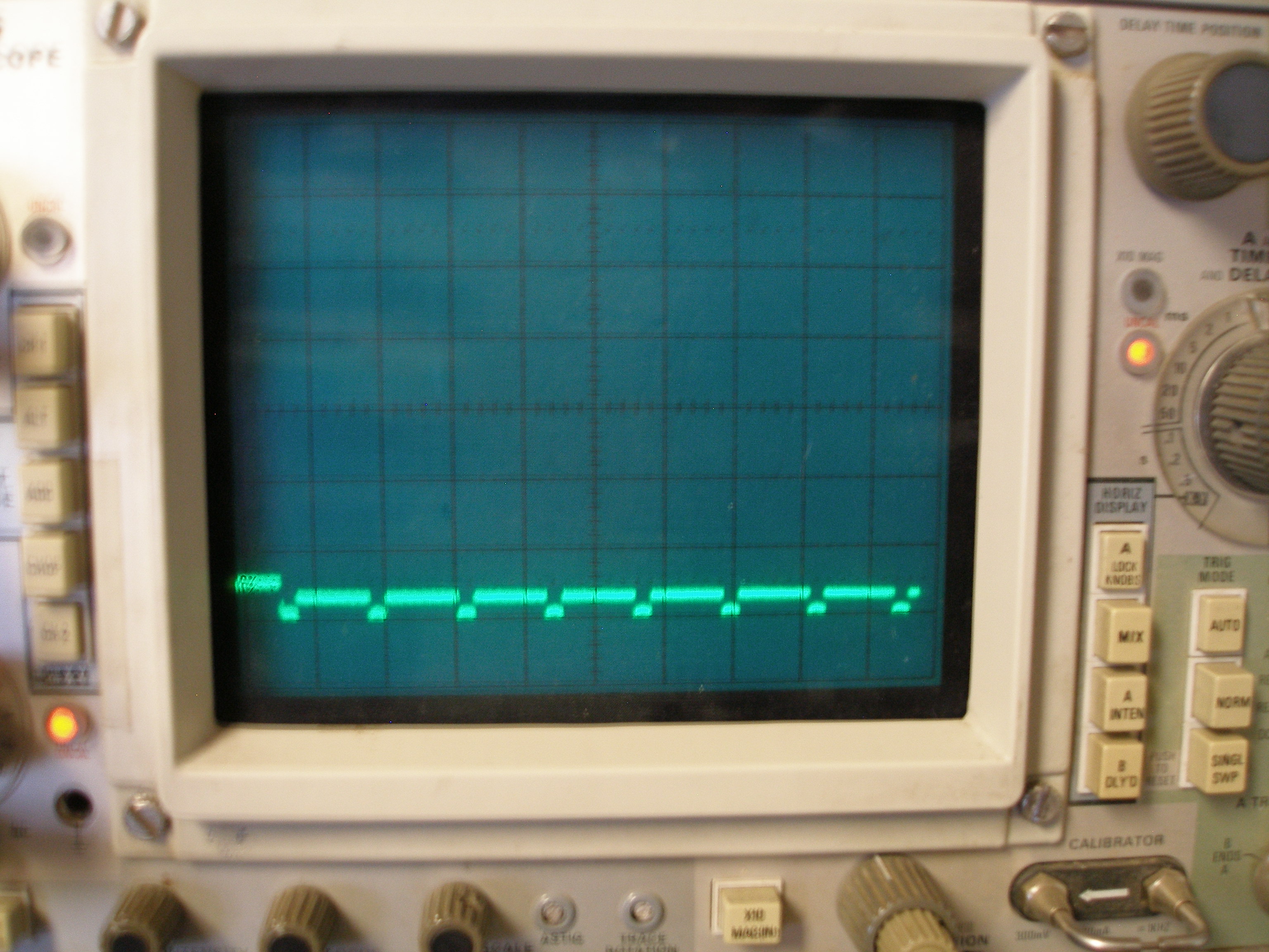

Ok, Using a DVD just displaying its on display (mostly stationary) I have video signals at pins 3,5, and 44,45 at a lower voltage. No change in outputs 20,22, and 24.
I took a closer look at the schematic and it traces the video signal (Should have caught that sooner) It shows a signal at pins 1 and 15 of IC 401. I have it at pins 2 and 15. I suspect pin 1 is tv and 2 is video in. Does this indicate a problem with IC 301??
Photo 1 is signal in Photo 2 is signal out. same at base of video transistors on C board.
