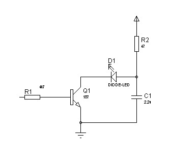

Dude thanks, i actually wanted to see the Schematic diagram not the code :D . Can you please send the Schematic diagram.
I am using the following schematic but the IR LED is still not bright enough.
I have also tried moving the IR LED into Emitter portion and reducing base resistor to 100ohm but only increases the range by a few Centimeters.
Ive been working with something similar using the 12F629 using Hi-Tech C, before I found this thread. My code uses almost similar technique to duplicate a car audio remote buttons. It uses a data table to store 16 bit values, it goes to sleep mode when not in operation and reduces current drawn to less than 2uA, ideal for battery operation. Jason has done a very good job I am always impressed with what he makes.
Haxan try this configuration for the transmitter, if you really want to see how bright the LED gets use a phone camera to see IR.

If i use a standard Sony Remote, i get range upto no more than 10 feet (with new batteries) Also sometimes the button pressed sends some other signal for example if 1 is pressed, it sends 2. Is there any way to reduce this noise (or whatever this is) and how to increase range.
The range depends on the remote & ir receiver but on my universal remote which I paid $4 for i can get about 20-30 feet. The receiver has to be in the correct angle. You have to remember this isnt a WIFI type thing its a POINT TO POINT comm. If its off by a little you look lots of feet. Also some IR Receivers can sense from further away. take the TSOP1138 and TSOP34838 they both work great!
For noise check the datasheet for more info.

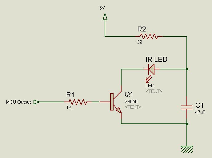

I have stumbled on another issue. My receiver section works great with universal SONY remote now. However, the remote i just made works fine but with very less range.
I dont know what i can be doing wrong. If the universal remote gives 30 feet range, mine only gives 6 feet.
I have used the same transistor (S8050) used in the universal remote.
