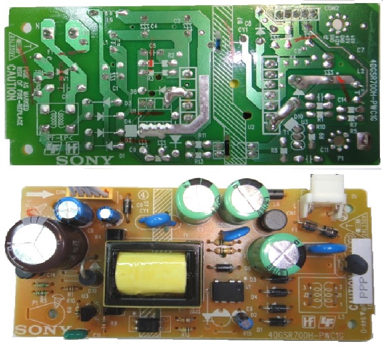

my sony sr700hp dvd player has no power..
I opened it and check output voltage.no voltage found
primary section looks fine...its on tny176pn ic(u1).
no shorts found.
I changed u2 and u3(tl431) by guessing.
no result.
what could be the problem?
thank you!

check the rectifier... and caps also...nothing wrong...its not getting voltage on the secondary side!
Bit hard to see from the image ... but are they 2 x 100k resistors above the IC?
I don't know the official term for them, but often the 'start-up' resistor/s go open circuit and cause a no go. Always check any high value resistors in the primary if no other obvious faults.
They are bleeder/startup resistors and indeed rather common to open up when there is no other obvious faults. In this case, they are actually 150K in parallel. R2, R3

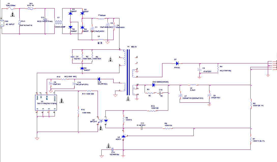

Looks like the posted pictures are directly from a Brazilian version of Sony's service manual(copy @ elektrotanya) and if you scroll further down, you'd actually see a corresponding schematic! While connecting lines are not straight but it is done on the same schematic program and complete.
As it was mentioned, it is very unusual to have any sort of power supply schematic for a consumer DVD!
https://elektrotanya.com/sony_dvp-sr700hp_sm_es.pdf/download.html

Ok, just taken a look at the schematic. Looks like R2, R3 are part of the snubber circuit and so probably not the direct cause - although worth checking as a faulty snubber could have killed the switching IC (U1).
Another thing that can cause poor startup (just running in little bursts) is a problem in the auxiliary power supply circuit - D5 open (unlikely) or its associated winding, or C12 gone bad.
There's really not very much to it - I'm sure you'll be able to fix it, assuming the parts are available.
yes this is the circuit diagram.

Just zoomed in on the schematic and noticed that R15 & C12 etc are marked as "NC" - if they are not on the board then the IC is in pure stand-alone operation and should only ever have 5.85V on pin 2, from its internal regulator.
If C9 has failed or drastically changed value that could prevent the IC functioning properly.
