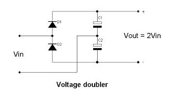

3 - I've already chosen the power supply, but I've been think about this for a long time: is there any simple way to double the +5v supplied by an USB port -getting 10v out of it-? For example, the equivalent of this simple AC circuit, but for DC:

3) You could get a cheapo boost convert from china off ebay, use that to bosst to say 15v from usb, then use a linear reg to step that back down to 12v or whatever to give you a reasonably clean supply rail, 12v directly from a switch mode boost converter might be a little too noisy for a sig gen.
Build yourself a linear PS or get a very stable no noisy (quiet difficult) SMPS.
In the latter case, all the noisy garbage will be amplified by the output stage amplifier (I suppose you will use one).
