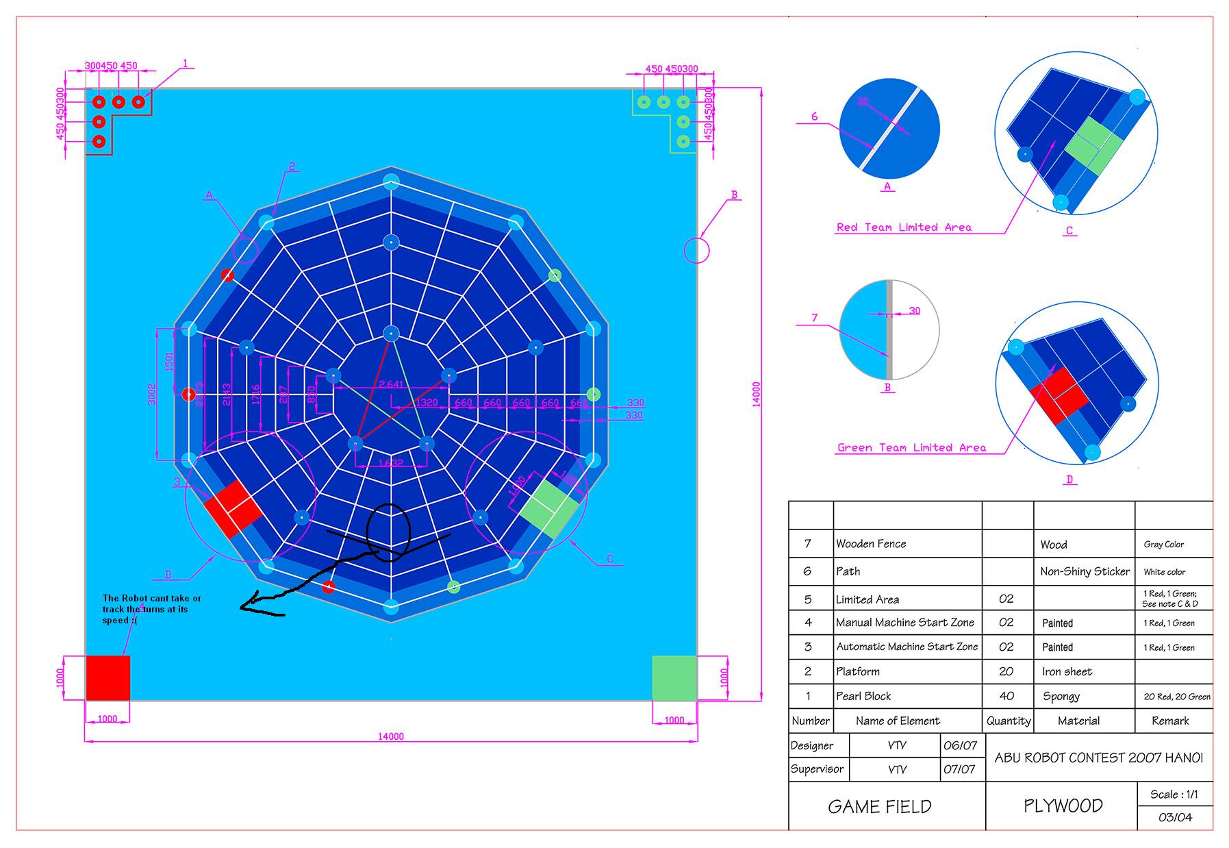

im trying to make a line follower robot , the sensors are constructed by compartors with the LDRs,they work well, but the robot moves very fast , it can detect the line , but it cant move at the turns , i attached the pic with the illustrations , also it seems that the sensor affected by ambient light should i cover it right ? , also i've a problem that the two motos arent equal in speed they are used motors so what can i do ?

but it doesnt follow the track at the crossing lines, at the crossing of the track i.e 1 1 of the two sensors,i let the robot to move forward , at this time the robot should track the line , it doesnt, it bends from the line away :S..

im using now 2 sensors , would increasing them to 4 or 5 make it track better and follow the crossed lines as the picture shows ?
