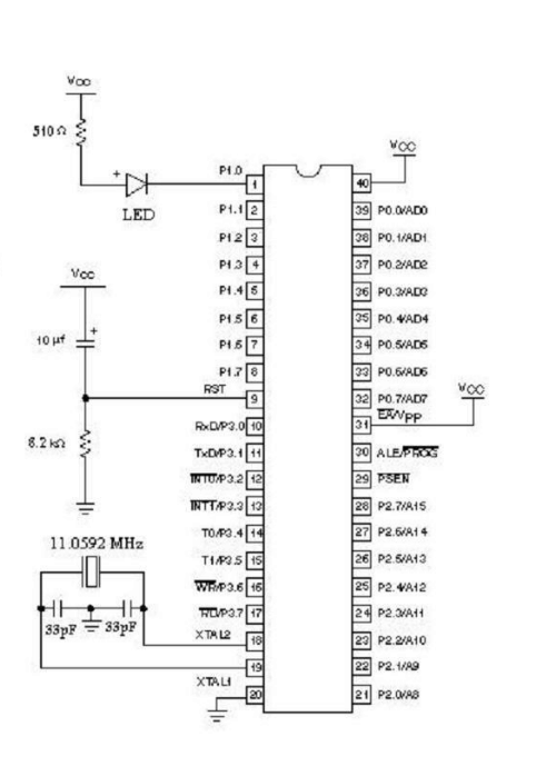

i planned to do some daring 89c51 based projects, and so i bought a flash programmer, 2 89c51s, and numerous other electronic bits and pieces like capacitors, oscillators etc, that made me broke!
and when i pluged the prgrammed 89c51 in the bread board, forget making 7 segments work, i can't seem to get a simple freakin LED to blink!
take this program for example:
ORG 0000H
MOV P1,#00H
HERE: CPL P1.0
MOV R1,#0FFH
BACK2: MOV R0,#0FFH
BACK: DJNZ R0,BACK
DJNZ R1,BACK2
SJMP HERE
END,
when i insert the micricintroller in, and turn the supply on,
NOTHING'S BLOODY HAPPENING...
there could not be any wiring errors, i've checked the simple circuit 100s of times!
the flash programmer seems to be working fine, i've replaced the 8951 too....
could someone please tell me what the hell is going on? this is a lot of money thst's going to waste, please help me people!
You need to post a schematic. You say that there is nothing happening, but that is not strictly true. In particular you need to convince us and yourself that the oscillator is oscillating and that ALE is beating up and down at the appropriate rate. Other pins to check are RESET* and EA*. Suboptimal connections there will have a dramatic effect.

come on people, alright i apolagise for bringing a third party in this discussion, but this ain't funny to me, by the way here is the circuit diagram of my disaster:

Make a one liner program first like writing 55h to the port.
If it's programmed the problem I'm guessing is with the crystal/capacitors.
