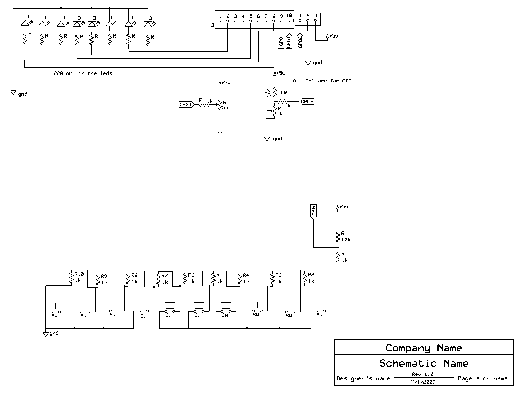

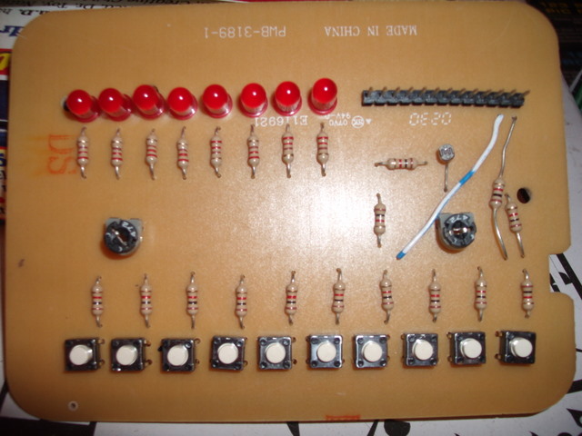

Here what I was making the GPIO Play ground I like play with 12f683
so i made this board to go with the one that has the pic and 74hc164 on it. It gives
me 10 switches and 8 leds and two adc toys a pot and a LDR to mess with.

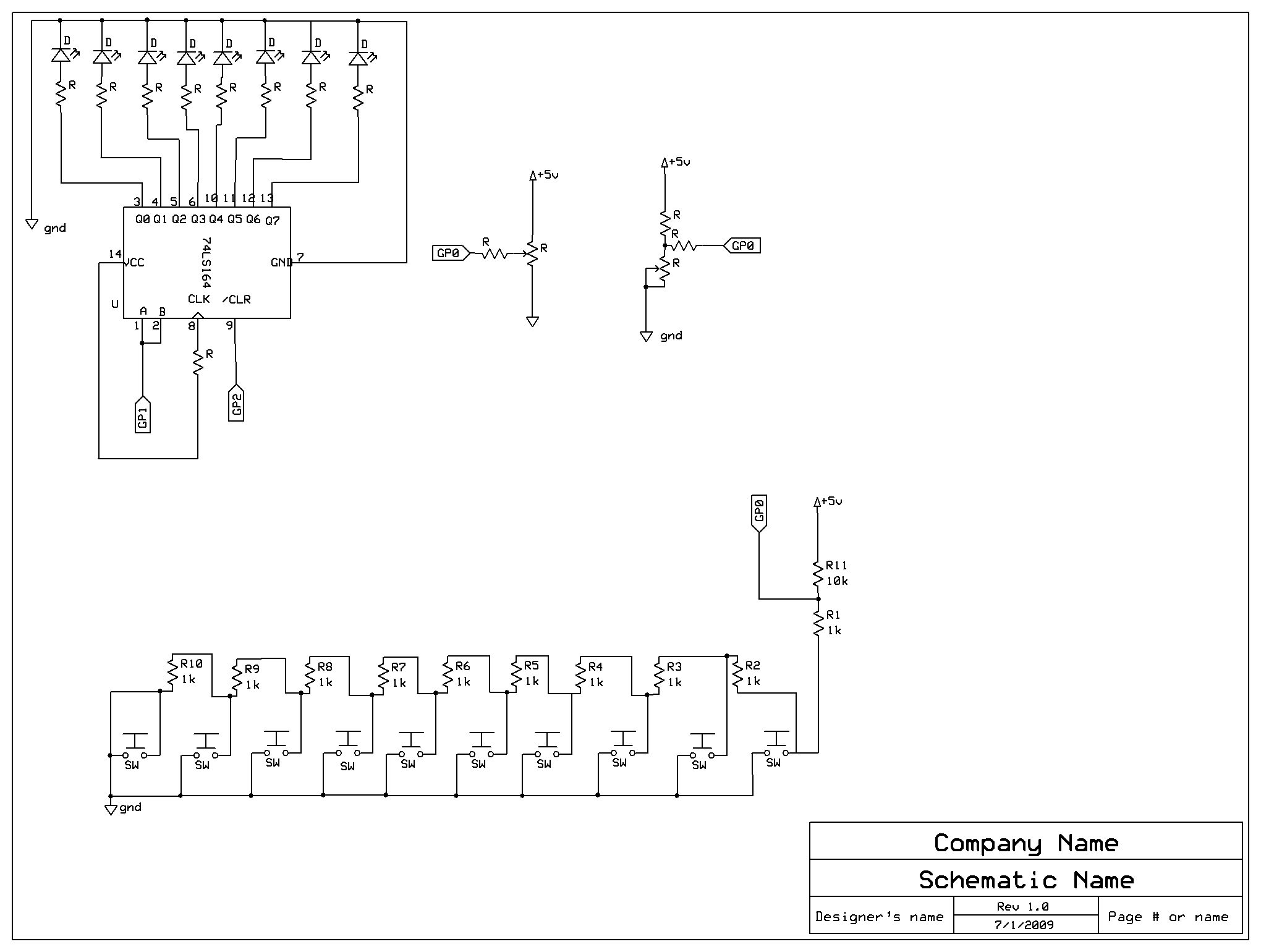

So, which port of the 16F844 has the analogue input?
Perhaps you should also ask, "Where do I find this mysterious PIC? It doesn't appear on the MicroChip site at all." :D
Mrdeb here the schematic for the test board I made
Sorry about that I didn't remove it all it was a 74hc164 but it's not on that board it was on the schematic I thought i remove it all my kids was trying to get me to take them skating and i didn't look it over good I fixed it should make since now.
