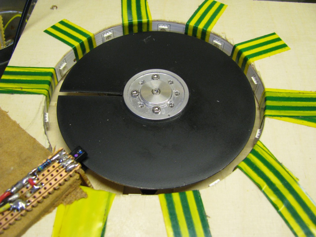

well now, that's true! i'm currently using an opto-pair to detect each round, but, it still troubles me that won't even slightest change in rpm cause unreadable display? i mean when leds are not in sync with disc groove? or then i just didn't understood what you meant by ''making graft to plot the leds'' (language barrier...sorta?)
and just to make sure, here's my setup

I didn't see your picture till I got home your doing a slot in the platter type pov not a bunch of leds spinning on a disk. I wonder how a timing light on a car worked LOL Oh it lights when the sparkplug it's hooked on fires. You see the mark on the pulley even if the motor is missing the mark still shows.
don't think there's "phase locked loop control for the motor driver" there. Then you have the nob that changes the dwell ? what happens then Oh the mark shows up in a new spot.

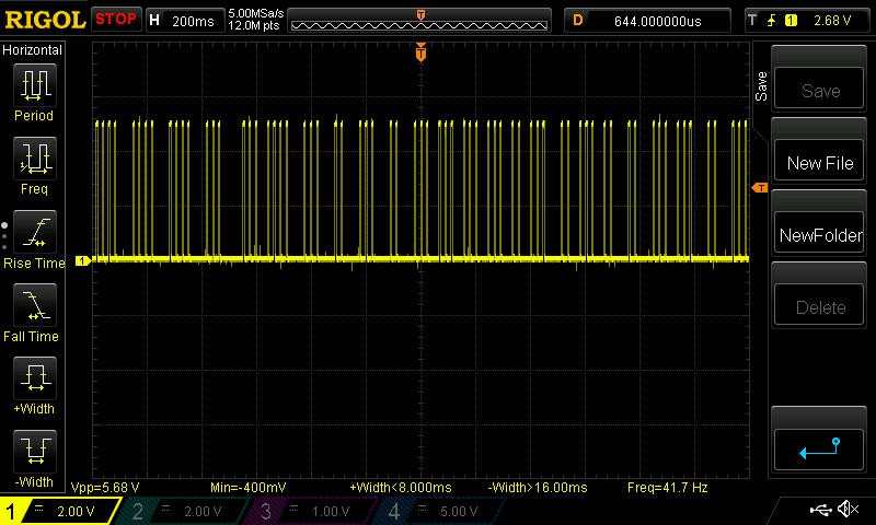

this had best success thus far when using interrupt, it does make that strange flicker, but that i think is due at least CHANGE trigger on interrupt
But, when i place FALLING, it blinks only every-other, so it misses one rotation and i can't figure out (yet) why...
