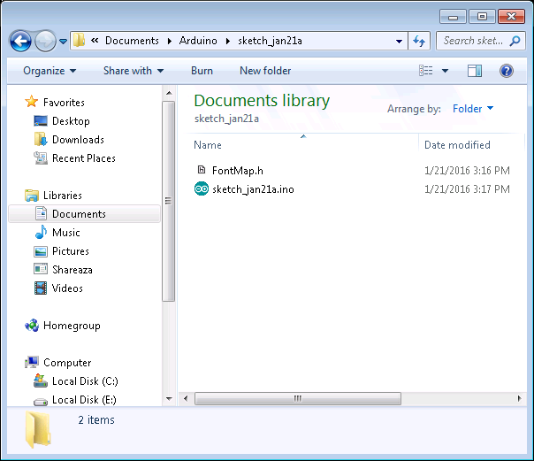

(Solved)Again problem with matrix, this time 8x32
dafug? I did try initilazing that addr2 at void where it points at, but those others are mystery
errors:
C:
Arduino: 1.6.5 (Windows 7), Board: "Arduino Pro or Pro Mini, ATmega328 (5V, 16 MHz)"
sketch_jan15a.ino: In function 'void charput(char, unsigned char, signed char)':
sketch_jan15a:93: error: uninitialized const 'addr2' [-fpermissive]
sketch_jan15a:96: error: assignment of read-only variable 'addr2'
sketch_jan15a:96: error: invalid conversion from 'unsigned char*' to 'unsigned char' [-fpermissive]
sketch_jan15a:97: error: assignment of read-only variable 'addr2'
sketch_jan15a:100: error: invalid type argument of unary '*' (have 'unsigned char')
sketch_jan15a:106: error: increment of read-only variable 'addr2'
  This report would have more information with
  "Show verbose output during compilation"
  enabled in File > Preferences.

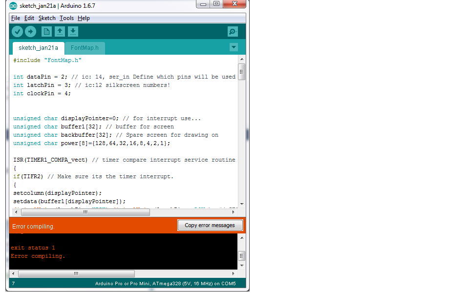

Doggy, sorry for delay, had migraine and it finally relieved....hate migraines!
But, that code showed long bars lit in leftmost matrix, upload shot in a few :)
take the time! we are just having fun anyway!

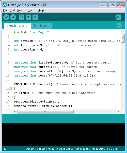

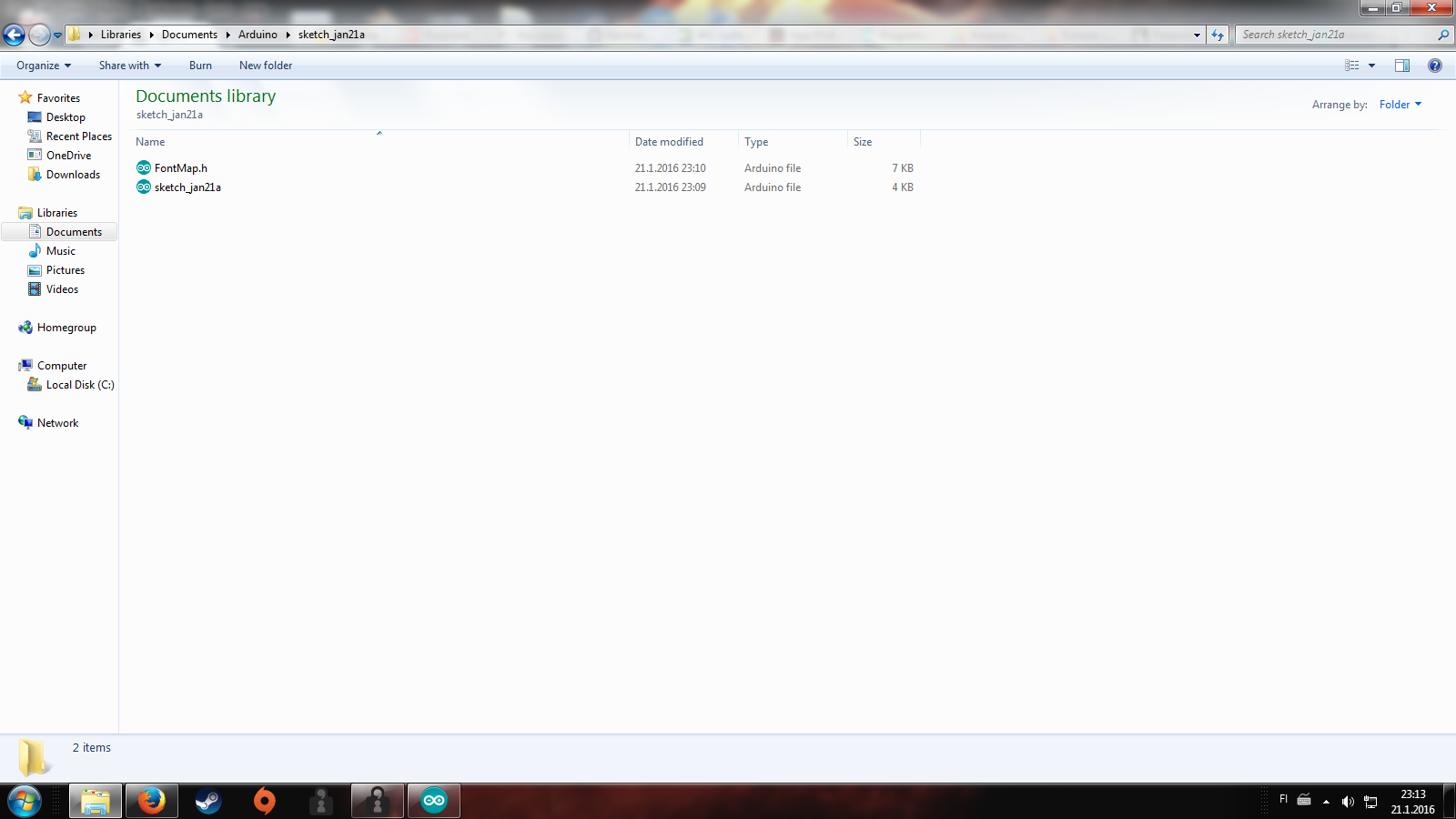

Here we go: (got teensy 3.2 today btw :))
tiney eh? hows that workin so far? all i have used is the atmega2560 and just recently got it, so far if this is c++ i can't tell, from c#, im happy i havn't had to use the confusing symbols from that lang so far... this conversion is common when switching compilers, btw , what is the chip you are using for this array? if this works....i am going to look at that interrupt setup next, but hard to find proper example.

Hmm, I made file called FontMap.h, in libraby folder, inside FontMap.h folder, but still gives error saying
C:
Arduino: 1.6.7 (Windows 7), TD: 1.27, Board: "Arduino Pro or Pro Mini, ATmega328 (5V, 16 MHz)"
C:\Users\Atte\AppData\Local\Temp\arduino_2644eeef3843ed767f171c329ce5fc54\sketch_jan21b.ino:1:21: fatal error: FontMap.h: No such file or directory
#include "FontMap.h"
compilation terminated.
exit status 1
Error compiling.
Adruino Compiler.....sketch....add file.....""
if it added it will show as a tab across the top, just under the "verify, build, ect..." buttons
no need for fontmap folder, just fontmap.h file, same folder as where the sketch file is
Hmm, ok with that same result, I see fontmap file in tab next to main skecth, it adds it ok but gives that error
FontMap.h is at same folder as sketch not
is case sensitive...(>?)
alt-prtScn key will do a snap shot, or else add your project to zip file and upload.....

ehh? file types are INO in both skecth and h.file
k, go to my computer, c , docs, adruino, "project folder, right click , add text file, name "FontMap.h" , ok to change file extention
oops, made that h.file wrong it seems, here's from your zip you sent:
