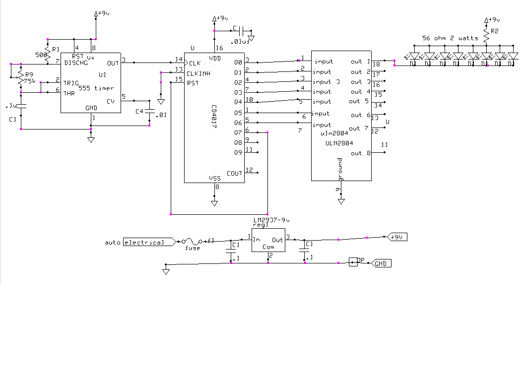

Well i have designed and built a simulated rotating emergency light. Two actually. BUT, the only thing they do is turn on. I need a help with a design that would make each row (8 LEDs) light immediately after the preceding row. There are 6 rows per setup. The LEDs run 3 VDC at ±40 mA. Is there an IC (or several) that can be used and then a plethera of resistors to make this work? Source voltage is 12-13.8 VDC, the rows of 8 are wired in series so i really only have 6 large loads in every light assembly. By the way, it would be nice to have a variable "rotation" speed, but i dont need any patterns. just a consistent interval between 'firings'.

You can use and IC called a 4017. It has 10 outputs that turn on one after the other. If you connect the 7th output to the reset input, then it will cycle round after the 6th step.
You need something to time it. Electronoize Playshop: 4093 Oscillator shows a simple oscillator.
**broken link removed** shows the idea very well.
You need a transistor for each output of the 4017 as the outputs can't provide enough current unaided.
It would be a good idea to have just two or three LEDs in series. If you have two in series, that will have a maximum voltage of 6 V. You then need a resistor of (13.8 - 6) / 0.04 = 195 ohms in series with each pair. 220 ohms is a standard resistor value, so you could use that an just get a bit less current. You can have as many groups, each with two LEDs and a 220 ohm resistor in series, by wiring each group in parallel.

this should get you working
using the uln 2804 seems easier than a bunch of seperate transistors.
I show only one set of LEDs
I believe you mentioned for an automobile?
PLEASE don't breakl the law using this
you may have to adjust the resistor values to suit your needs.

Oh ok. some dont like to stay on and i see why thats a bad idea. Im planning on soldering. Now, what are all the components i would need for these rows to work? I get the different ICs, but what about resistors, capacitors, etc? Earlier you warned me about breaking the law, its actually for use on a golf cart any way. I dont think i will have any law problems. Each of these LEDs is about the same and i dont think will matter much, although i defininately know what youre talking about. I have some $0.001 each LEDs that are, unmentionable to say the least.
He will have to adjust the resistor values because the LM2937 is manufactured for 5, 8, 10, 12 and 15V output. (no 9V type)

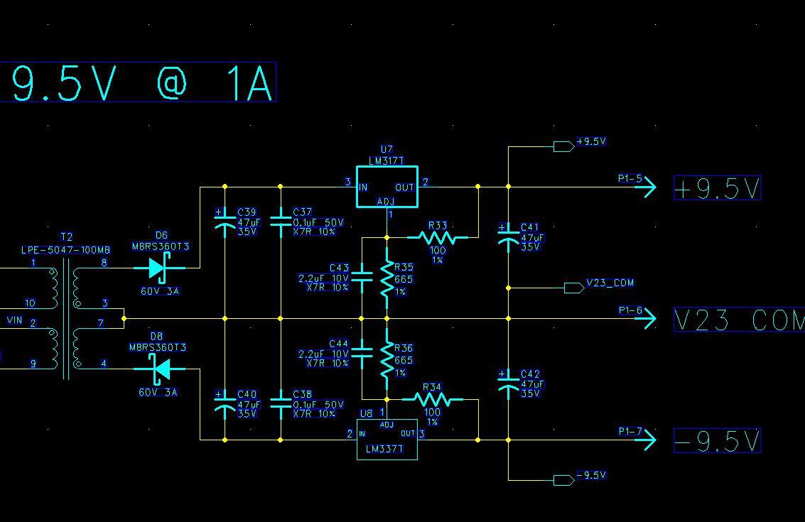

don't they make adjustable supplies anymore? I use the LM117 with two resistors to get 9.5V on my 80W supply
this is for an automotive application thus a LDO regulator is the perfered component of choice IMO as well as other members here in this form. Yes an LM317 would be a nice choice but not for an unstable input voltage supply.
