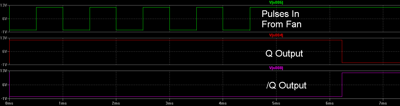

Beyond the CD4047 I have done similar circuits using a 74123, check out this link for an example. What you are building is a retriggerable one shot multivibrator. See page 11 of the link, Figure 12. Missing-Pulse Detector. Typical fans output 2 pulses per revolution I believe. So you set a R and C time to where if the incoming pulses from the fan drop below a certain RPM output or no output. Then use the Q or /Q output to do whatever you wish to do. You would likely use a CMOS version like CD74HC123 or HD74HC123A.
If the fan speed returns the chip will toggle. That can be changed by adding another chip depending on what you want to do. Anyway, I would likely start with a missing pulse detector approach.

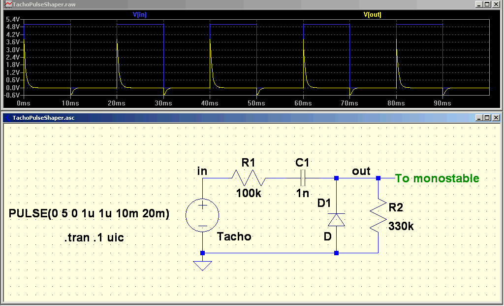

how to adapt the fan's tach output to the CD4047 to go 'low' when it stops spinning
If you AC couple the tach signal (i.e. via a capacitor) to your circuit it won't matter whether the signal stays high or low when the fan stops.
I was thinking something like that might do the trick, but I'm not sure how to implement it. Is this just a matter of resistors and capacitors on the input (like your suggestion that saved the day in my other thread)?
Here you go. The traces are for a 5V input pulse, but the same components would be used for any voltage (within reason!).

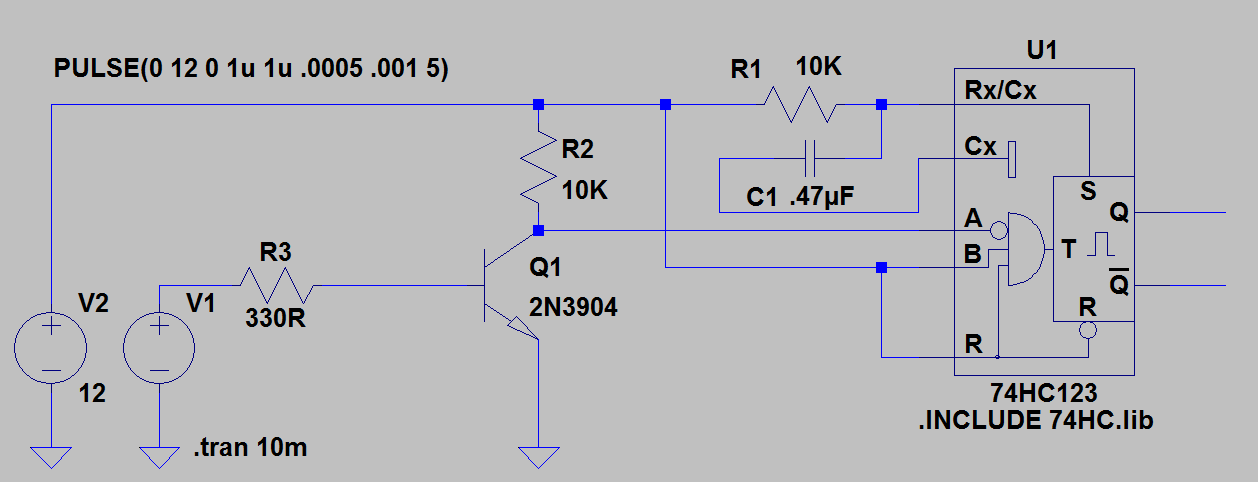

You can use a cap as alex suggest for coupling. Configuring a 74123 as a missing pulse detector it won't matter. The chip won't care if the input is high, it only cares about pulses.
I haven't uploaded a picture in a long time so hope I have it right. The only reason the 2N3904 Transistor is in there was to invert the pulses so they stop on a high level. When the pulses stop the Q out toggles low. The Q out would drive a DC SSR Like This One. Click the link for the product then that will get you to a data sheet. That or let the Q out drive a good power MOSFET. Note, this is merely one idea as to go about doing what I believe you want to do and that is shut down heaters if the fan fails. Working with large walk in ovens if any of the blowers failed the sensors were air flow switches which were a small paddle on a micro switch.
Thank you again! I didn't have a 1 nF capacitor on hand, but even without that exact value this basic arrangement worked.
