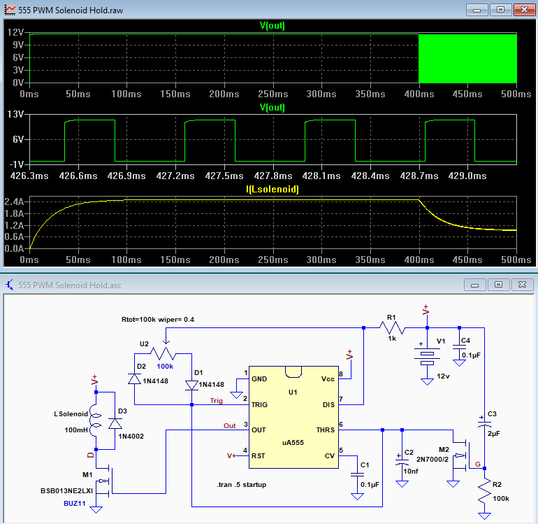

Okay, here's my KISS design. :D
When power is initially applied, capacitor C3 turns on MOSFET M2, which pulls timing capacitor C2 to ground.
This keeps the 555 output high and applies full voltage to the solenoid.
The value of R2C3 give a delay of about 400ms before M2 turns off and the PWM starts.
This can be varied by changing the value of R2 or C3.
The PWM frequency is about 1.3kHz with the indicated values of U2 and C2.
This can be varied by changing the value of C2.
Note that the solenoid current goes to its maximum at start and then settles to the hold current at about 500ms.
The hold current can be varyied by adjusting pot U2.

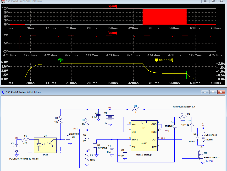

Here's the circuit modified to operate from an optocoupler input.
I added MOSFET M3 to hold the 555 Reset input and the delay capacitor low when the opto input is zero.
As you can see from the simulation, the solenoid current is off while the opto input (V(in) from V2 is low and goes through the energizer sequence when the opto input signal goes high.
(Note that the 555 DIP package pinout is shown looking at the bottom of the package.)

Theoretically this works well. But when loaded with the solenoid, the MOSFET does not manage to shut off and I get huge backpulses from the coil destroying the 555 within seconds.
D3 is a fast switching 1N4004, M1 is a FQP30N60 (60V 32A).
Yes, the scope show attempts at pulsing on and off yet the load voltage remains at supply voltage.

When the mosfet attempts to shut down (at each oscillator downpulse) a counter-emf spike (up and down) is generated and the coil remains at its supply voltage. The frequency of these pulses is the same as the oscillator frequency. I will post the scope screen in a few days, now I have broken down the breadboard setup: I will have to be real fast because within seconds the 555 goes up in smoke.
The measurements were done at the mosfet drain.
I may have to get a 5k or so resistor between G and S, if that would help?
You might also want to add a gate-stopper resistor, and 100uF or so directly across the 555 supply pins.

I don't understand how the 555 is getting zapped. :confused:
You might try adding a 10 ohm resistor in series with the power to the 555 and add a 100uF cap from the 555 power pin to ground.

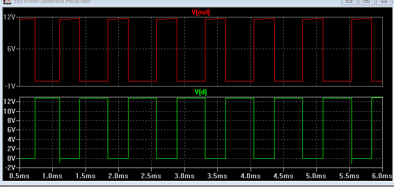

Below are how the voltages should roughly appear at the MOSFET gate, V(out), and the MOSFET drain, V(d).
