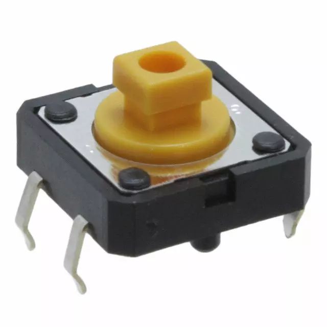

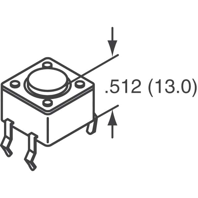

I had thought about spacers behind the switches, but there are 5 switches, and the legs are..um...crimped...to snap into a standard thickness board. The position of the switches in critical to fit the panel. the position of the beeper not so much.beeper 2.jpgbeeper 1.jpgB3F-4055.jpg

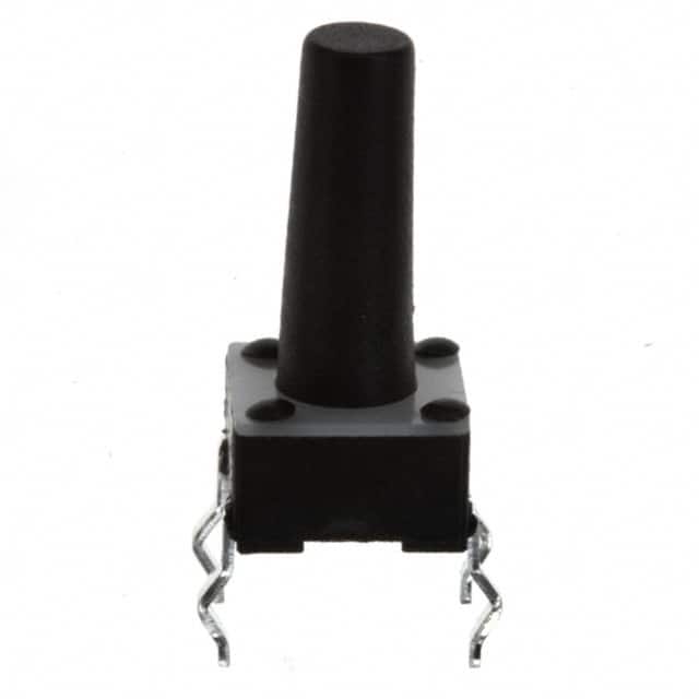

I think these type of switchs are made in any height in 1mm increments. Trying to say get a switch that matches your piezo.
Those switches don't have the type of caps I want to use. 12mm tact switches don't come in (meaningly( different shaft lengths.

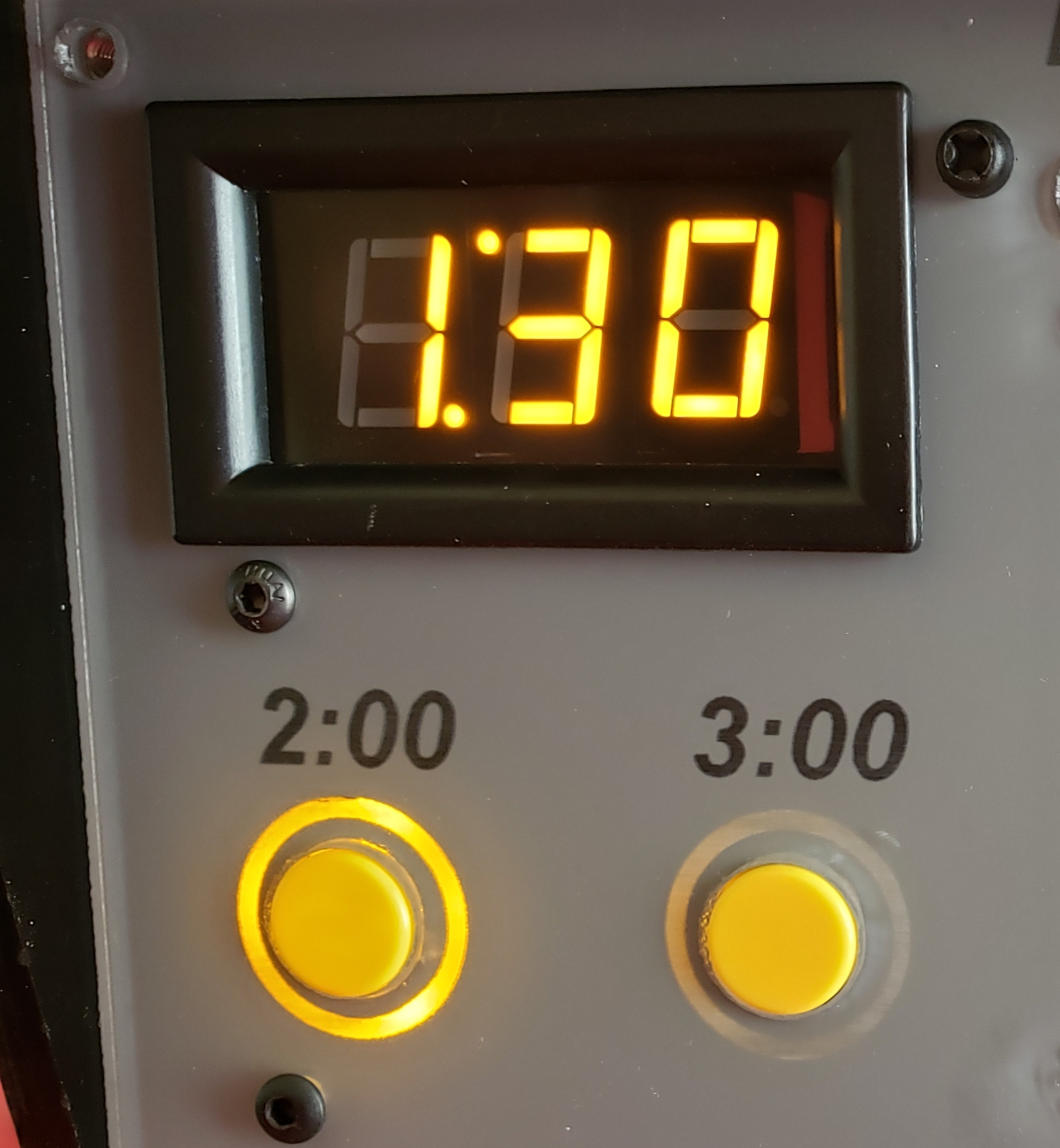

I'm not really ready to go public with this yet, but here's a partial picture. The original version uses flush-mounted EAO switches. These are nice switches but cost about $25 each, have had a 6 - 8 week lead time and they act like they are doing you a favor selling them.
In a cost-reduced model I'm working on, the $25 switches are replaced with tact switches and LEDs behind the panel, at a BOM cost of less than $5. My goal was "not to build crap" while reducing costs significantly. I've managed to do that and more. The switches have a good feel, and the LED rings provide exceptional visibility.

The illuminated switches look good. Have you considered switches with the LEDs built in? Such as these.
Edit, or is that what you're currently using?
I have tried those in the past. They don't extend far enough to work with a 3mm panel. Also, the button size is much smaller than the 12mm caps I'm using.
