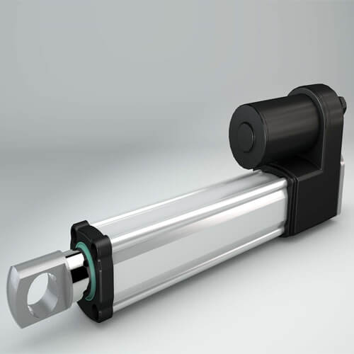

With limited mechanical supplies I figure it will be easiest to use 4 actuators in each corner of the trailer, using the diagram posted,
I figure that will be the easiest configuration. It doesnt seem stable to have it all sitting on a single bar in the center like most mounts i see.
The actuator i found with a low price and high stroke is:
so can i assume that each actuator will need to support 200/4 = 50lbs, plus the fulcrum adjustment(20" = 1.5ft) = 50lbs*(5/1.5) = 166LBS
I dont know if that last paragraph is correct or even made sends(probabally not)? or how to properly calculate? will the actuator posted be enough(900N)? should i use somthing other than 2x2 lumber for mount and arms? is there simpler config? ideas?

So mine is only half the area as his, so does that mean I only need half the newtons (750N)?
Plus i am using 4 of them, for each corner.
In which case the actuator I picked is coincidently almost perfect?
