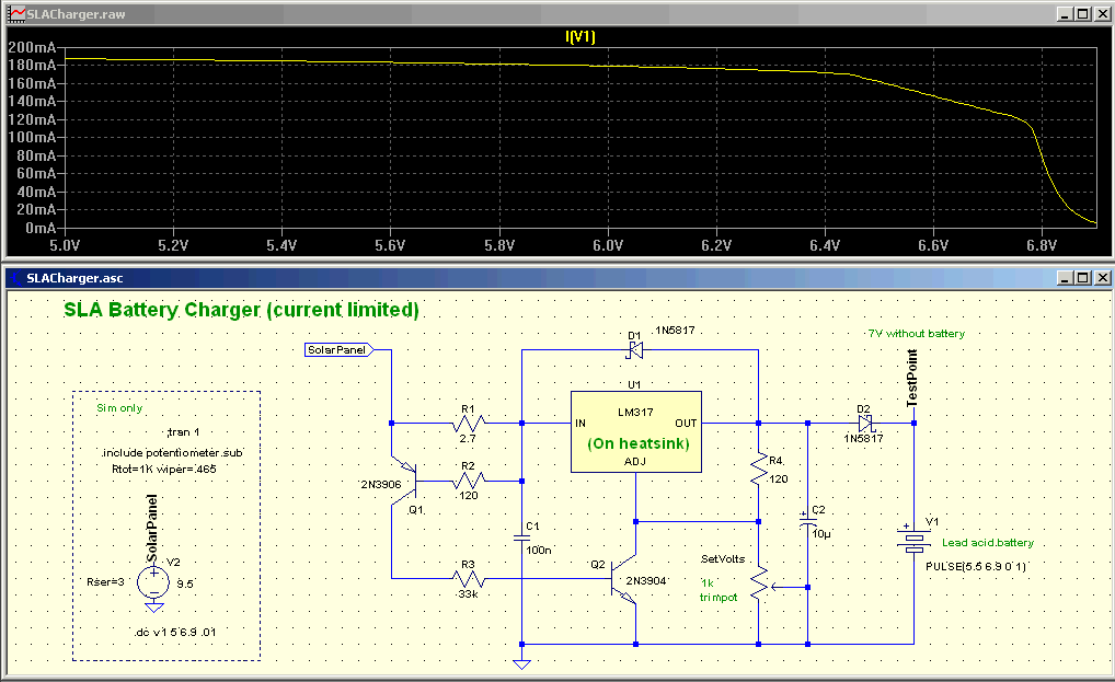

You may find this zipped LTS PV + SLA project interesting.
You can use a PWL to vary the [VLUX] 'sunshine' on the PV panel
Sim created using LTS_Yahoo group models.
Edited the 12v SLA to 6v SLA
Eric
PS: the major divisions along the Xaxis are hours.

I bet the shunt regulator that Eric suggested would work for you.
it'll be used for emergency light..... all most every day.........
In that case will a fixed shunt regulator at 6.8V allow rapid-enough charging to maintain the battery at full charge? I think something more elaborate is called for. Perhaps a 7V reg which shuts off, or reduces the regulated volts, once the charge current has dropped down to 20-30mA, then turns on/reverts to 7V again when the battery voltage has dropped down to 5.5V or so?
Ok, I'll go along with that thinking. With a 6.8V shunt should we be able to leave the charger on indefinitely without harm to the battery, just float charging? Or is it still worth trying to chop it off once 20-30mA is reached?
