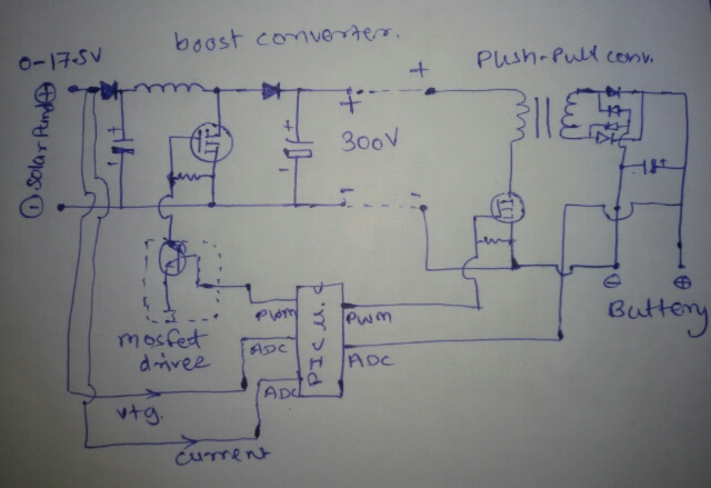

Hello everyone. I am designing mppt charge controller. I have been reading on the net about the mppt algorithms and coverter topologies. But I am confused. When you use buck boost converter it will draw maximum power and give output. But I doubt it will take care of battery?
As it will consider battery charging voltage then it will not be able to get maximum power from solar panel (all these are my assumption).
I always have hated buck boost converters. I know much more about push pull converter and implemented the circuits. Can I design MPPT using push pull converter. OR as shown in the attached image.
In the image the first part consist of boost converter which will "take care" of MPP. And the second part consist of Push pull which will "take care" of battery charging. Also I can charge the battery from mains converting 250V AC to 300VDC using rectifier. Is this possible? I would like to implement the circuit shown in the image. Thanks.

Nothing obviously wrong with the schematic, and the overall design will work. but it is less efficient than a true buck-boost circuit that can do all of it in one conversion stage. The advantage to your circuit is that it has the 300 Vdc intermediate point where the AC power line can be switched in. The disadvantage is lower efficiency from the solar panel.

How buck boost converter will draw particular value current at particular voltage whicb is our maximum power point and give exactly charging voltage (12-14V) as output? ( I mean I don't get how the three parameters (input vtg and current AND output vtg) are controlled at the same time? )

The buck/boost regulator designs I've seen and done are basically output voltage regulators. As the input voltage wanders around, they hold the output voltage a constant. They don't care about the output current until it approaches a self-protecting current limit - then the output voltage sags. For the typical user, the only difference between a buck and a buck/boost is that the input voltage can be lower than the output.

Negative: When charging a battery with a Solar Panel, the charging voltage is determined by the battery. The MPPT controller becomes an impedance matching device that allows the panel voltage (power output) to be at the optimum point while the battery voltage is whatever the battery voltage naturally is... The dependent variable being controlled by the MPPT regulator is the output voltage of the panel (input to the MPPT).

So I calculate input power using V and I and then adjust duty so that I get maximum power (P&O method). And then using push pull converter charge a battery.
