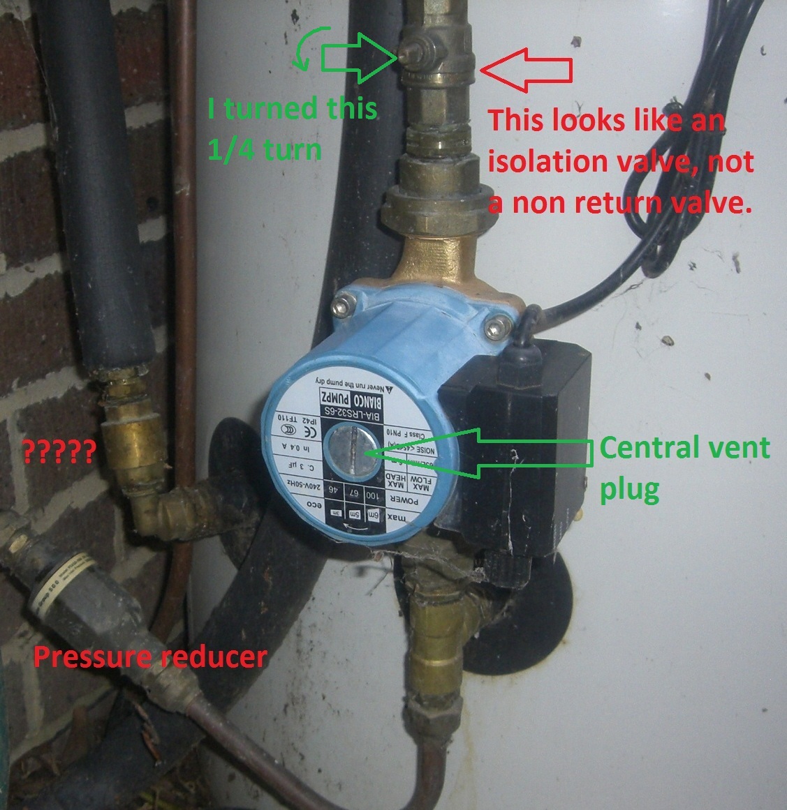

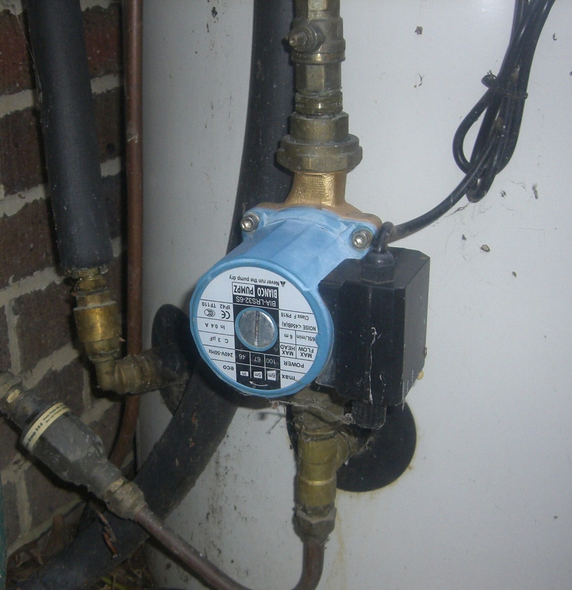

Unfortunately, the pump in the link is not mine. See the attached photos.
As you can see it is a sealed unit.
It looks as if I'll have to cut the water off to remove the pump to inspect it.
Yes, something may have broken inside & jammed it.

Hi Len,
From taking a close look at the photos there does appear to be an isolation valve above the pump but none below the pump. This could mean you will need to drain the tank to get the pump off or have a nice mess to clean up. What I would do ( after isolating all power) is loosen the 4 allen head bolts and see if any water leaks. I showed a mate on irc your pic and he did say his looks the same and you can take the motor off and it is sealed from the water. By the sounds when you said it was too hot to touch there is a good chance the motor is burnt out. Hopefully you can take the motor off and not have a big mess but as you said it has been playing up so it may pay to start looking for a new inline pump. If you endup going that route do a bit of plumbing and put an isolation valve under the pump so if the pump ever goes again it will be easy to take it out.
Cheers Bryan
I notice this pump as with most these days has a thermal cutout -It is likely no damage has been done to the motor but a strip is necessary I suggest.
Before anything try the center screw on the pump ,turn it to 6M head and try -it may be that whatever circuitry they have in there is corroded or kaput and it may work on the 3M or 6M setting.
As far as water flow, its probable that little water will flow out if you can stop the air getting into the tank while you are checking the pump. with the upturned tube and fittings below the pump air will not be sucked in and therefore water cannot flow out as long as no water can get into the tank from the top while you are doing this -Think about it -Like an upturned beer bottle full of water in a dish full of water. Until the dish level falls to allow air to enter no water can flow out.
That said though the non -return valve above would allow air in .If it is an isolation valve as mentioned then make sure it is off.

I had a close look at the pump & T junction below it.
I see what you mean. When I remove the pump, the water level will be level, so no air will be able to get in - as you said - using the bottle example.
Provided that the isolation valve is closed, no air should be able to get in there either.
So I won't need the dry ice.
Thanks for the suggestion.

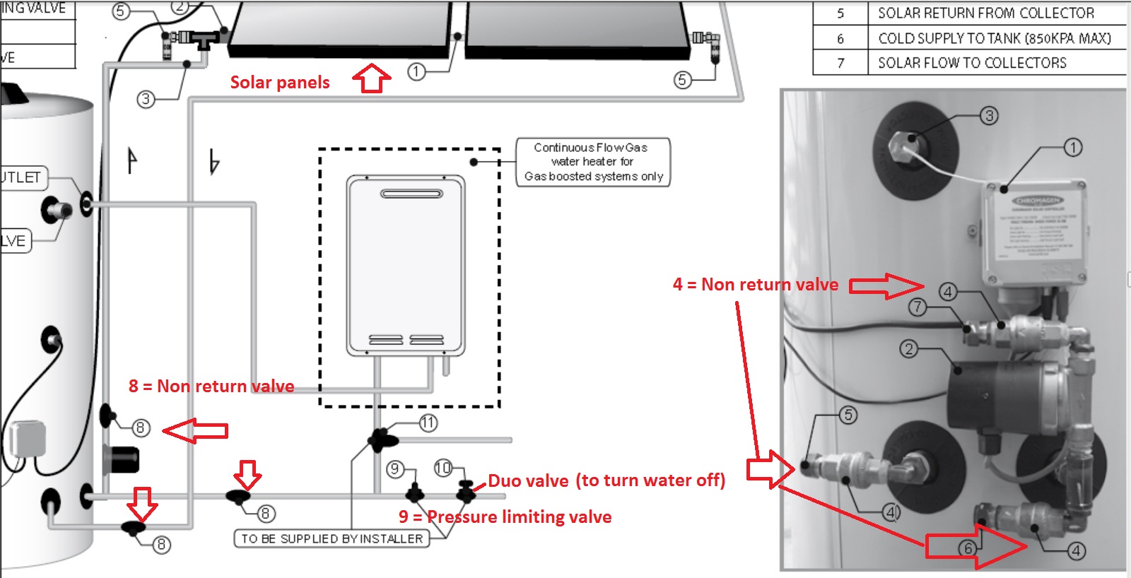

The attachment "System diagram" shows an extract from the Solar System Handbook (from the link kindly posted by killivolt) that shows a diagram of the plumbing.
You will see there are three non return valves (NRV) shown, but in the photo "Pump & Tank 1", there does not appear to be any NRV with the possible exception of the device indicated by ????.
However, the isolation valve and the pressure reducer may have non return valves inside.
I followed the instructions in the solar system handbook page 11, paragraph 8. Fault finding - causes and remedies.
This indicates that to test whether the motor shaft has jammed, to remove the vent plug & and turn the shaft with a screwdriver.
So I turned off the cold water supply, turned the isolation valve anti clockwise & depressurised the system by briefly opening the pressure release valve (not shown).
I then unscrewed the vent plug indicated by the green arrow and attempted to turn the motor shaft with a screwdriver.
The shaft would not turn either way despite applying a moderate to firm torque on the screwdriver.
So it would appear that something has jammed the shaft.
So I will have to remove the pump and dismantle it.

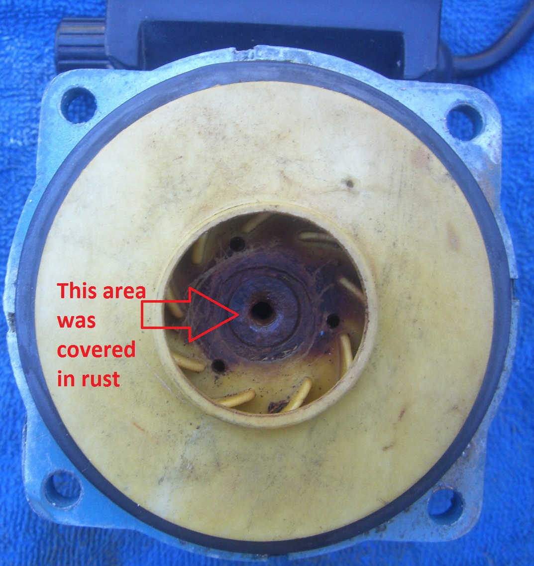

I removed the pump using tytower's suggestion, thank you, and no water flowed out except what was in the pump.
As you can see in the Old Pump photo, the shaft was rusted so I assume the bearings were also rusted as it is lubricated by the water.
So obviously, they used mild steel rather than stainless. Thanks very much, Bianco Pumps.
I called the company that supplied the system, and they said they now supply a different, better pump made by Grundfos. See New Pump attached.
Hopefully it is made from stainless steel.
