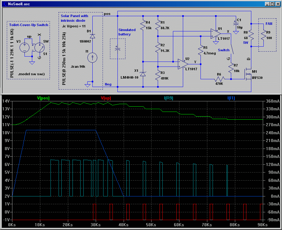

Ok, here is my hack at the NoSmell circuit.
Because this should have a low stand-by current, I changed the approach a little bit. I am now using a **broken link removed** "micropower 10V Voltage Reference" and a dual **broken link removed** micro-power voltage comparator(s). This makes for a design that draws less than 500uA during idle. Refer to the schematic.
U1 detects that the battery voltage is less than 11.6V (about as low as a SLA so be discharged), and is used to prevent the fan coming on.
U2 detects that the battery voltage is greater than 13.8V (the highest allowed float voltage for a 12V SLA), and starts the fan. I put hysteresis on this voltage detector, so the fan runs until the battery is discharged about 200mV. This turns the overcharge regulation into a multivibrator, where the fan turns on, runs for a while, then turns off while the battery voltage increases, then runs again.
Since the load caused by the fan is less than the output of the solar panel, I would be inclined to get a second fan, rather than just waste the excess power in R8. I am using an NFET as the fan switch because it is voltage controlled, so low power.
Now refer to the simulation. The time scale is arbitrary. Initially, the battery V(pos) is discharged. The panel output current is I(I1). As the sun begins to shine, the battery voltage increases as the battery charges. At ~14Ks, the battery voltage trips U2 (Y goes high), which turns on M1. The fan current is I(R9) . As the sun shines brightly until 30Ks, the fan cycles on/off, keeping the battery voltage between 13.8V and 13.6V. The hysteresis is controlled by R5, and you might have to play with it a bit to get the fan to run for a minute or so at a time.
I am using a voltage-controlled LTSpice switch to represent your cover-up switch. The signal V(up) is >0V t0 close the switch, so each time the red trace is ~1V, the cover is up. That event is asynchronous with the fan running due to excess charging. You can see that occur at 29Ks, where the switch causes the extra fan cycle. After the sun goes down, I keep cycling the switch, each time removing some charge from the battery. Finally, at ~78Ks, the battery voltage is down low enough that X (U1) goes low, so that prevents M1 from turning on thereafter, so future switch cycles do not run the fan.
What do you think?
Hi namesake (Mikko is the Finnish version of Mikael, so propably we are namesakes).
The simulation shows that the circuit fulfils all the tasks I originally planned. I will build the circuit in the near future and test it, when bright spring days are here. Today the sun is still low and the sun radiation is absorbed or scattered by the atmosphere and the highest current I can get from the solar panel is about 60 mA.
