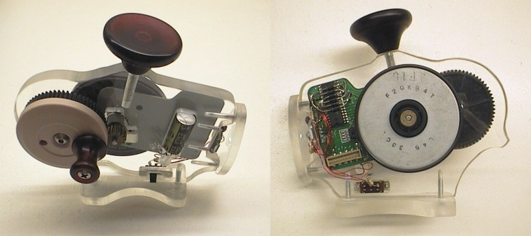

And I decided to make a rechargable human powered lantern with a 1W white LED and small 3.3F supercap;
Picture can be found here; https://www.romanblack.com/CoolStuff/lantern.jpg
The 3 phase capstan motor has no cogging and is very efficient making current at low cranked RPM, and it is smooth and quiet compared to those nasty geared dc generator crap torches they sell in the stores. Although it needs cranking every couple of minutes it's a great carry around type lantern for blackout jobs where I never have to worry about the internal battery being flat as it is a cap. :)
