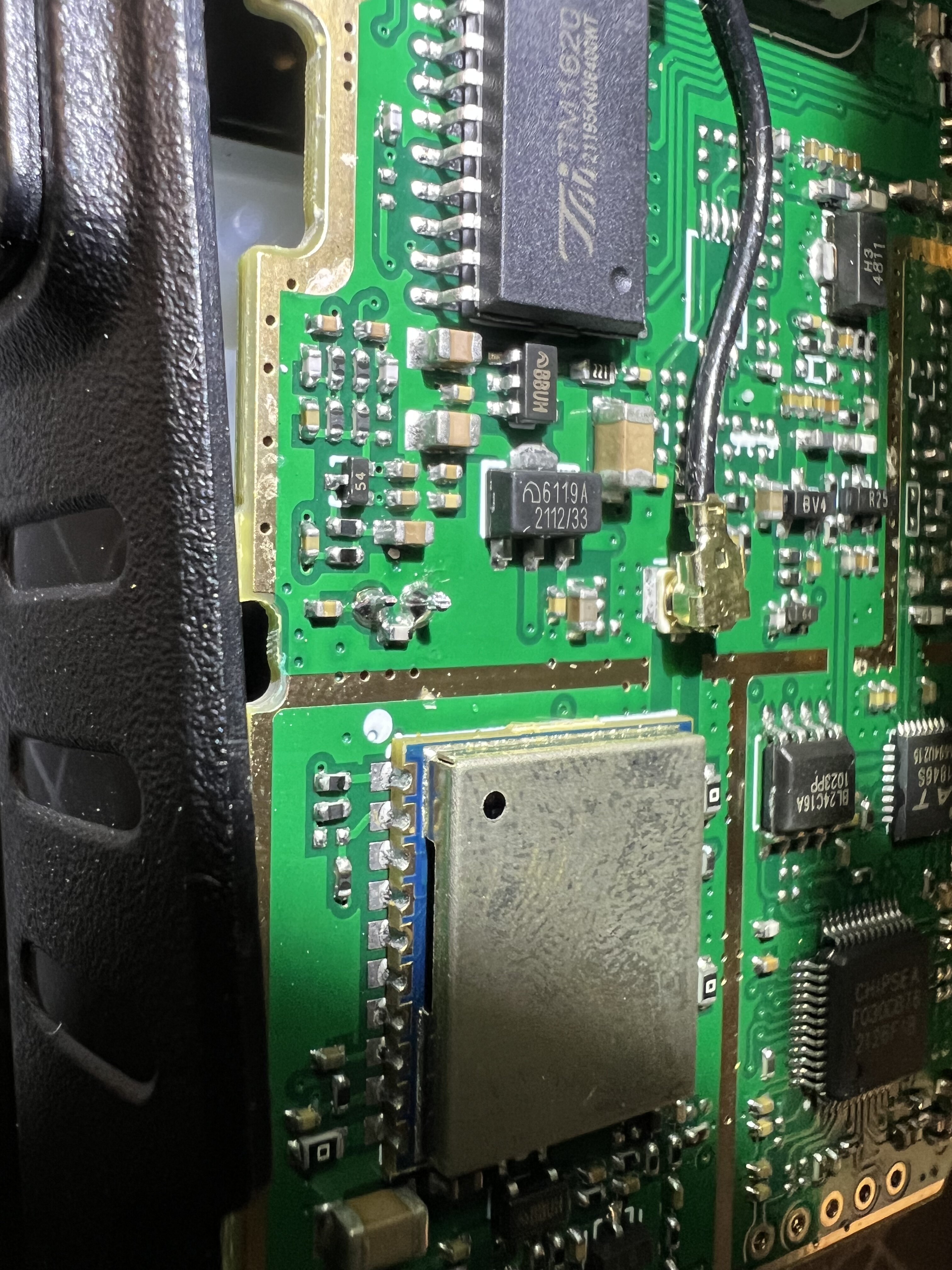

Ok as I opened up the radio, I realized there was indeed a Headphone And Microphone Jack. It was under a rubber side cover. I didnt have my soldering kit to unsolder the antenna so I got the best shots I could under the hood.
The small Black round thing to the right of the Black and Red Speaker wires is the Microphone. Picture 3 shows a good backside visual of its placement.

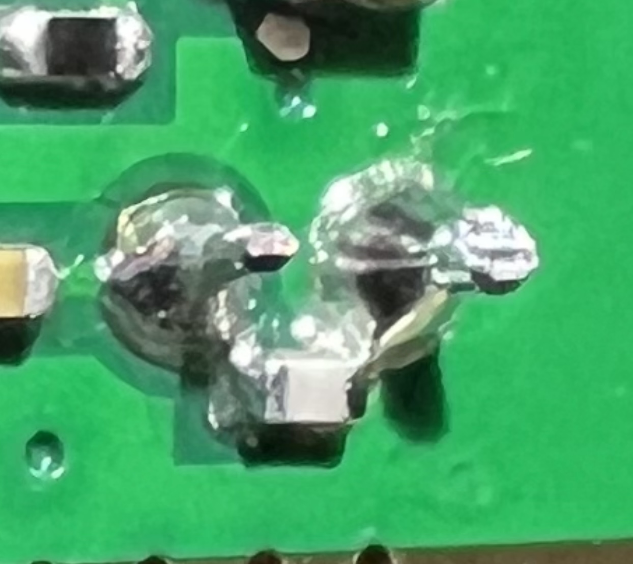

I just realised that the soldered connections on the back of the mic do not look all that good - can you get more photos of that area?

Lets say the hard wired Mic is faulty. Seems simple but I am worried about desoldering it with that super tinny resistor soldered between the + and - pins. How does one go about soldering things this small? Any special equipment?
OK, it was just the angle of the first photo, with the long leads obscuring things.

The transistor circuit near the mic could be the preamp?
(I initially though the big I could include audio processing - but seeing the number, it's the LED display driver).
That white component is probably a ceramic capacitor for RF noise suppression. You should be able to use solder wick to clean up the joints and remove the mic. When refitting it, use a toothpick to hold it in place while you reflow one end.
First, though - the big surface mount module with the screening can looks to have some dubious joints. It may be worth going along those and adding a bit more solder. If one is the analog audio, a cracked joint could easily cause problems.

I have a Meter and a Soldering Iron. I have a few other pieces of special equipment like a Digital Microscope. I should be able to fix it, if I can Purchase the correct mic or Preamp. Not sure I have fully identified the Preamp and its location.
