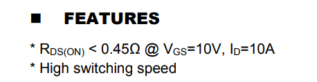

As for the transistor, hopefully, without getting scammed, I think I can get my hands on a >10A >500V Rdson<0.5Ohm MOSFET

There are new versions of it like KPS15N60F from 2015 https://www.docdroid.net/IRZPHxZ/15n60f-pdf with better ratings in all (except maybe a tad bit slower)
I found 15N60F PLS TO 220 version from UTC vendor for under 1$.
There is also 20N60 but it is slower with higher gate capacitance and response times, https://datasheetspdf.com/pdf-file/931299/UTC/20N60/1 but this is probably not critical as this is SMPS with at most a 100KHz switch frequency....
The vendors of those new ones are different (Unisonic Tech. Co.) Why the specs differ so much from vendor to vendor.
