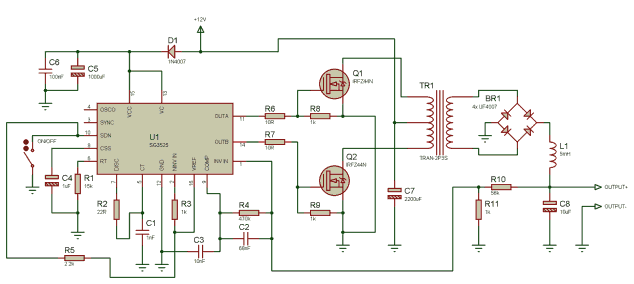

Hi all. I am building a mini cfl inverter using SG3525.
The selected frequency is 50 KHz. And I have winded the transformer. I found it in an old inverter. So I don't have its parameters but I could measure Ac wiz 0.75 cm^2.
So Ac= 0.75, frq= 50KHz, Bmax= 1500(?) Vin= 10.5V Vout= 220V
So N(Pri)= 6 and N(sec)= 128
So my problem is I get 250 V at OP when no load and current drawn is .33A. When I connect a cfl (20W) It glows for like half a sec and then suddenly output goes 0 V and current remains 1.15 amps. Sometimes CFL glows 'forever' (Vtg falls to 220V and Mosfets get heated). And then also current is 1.15 amps. But most of the times this doesn't happen. And everything gets heated.
Where is the problem??
I have winded transformer for the first time. Is there any mistake I may have made?
I am using P55 mos.
Plz help me.
Can you post your schematic?
for a CFL driver, you should use a proper CFL driver chip. There are lots of them, eg IRF do them...it drives the CFL properly. SG3525 is not good for that, you need square waves with variable frequency to regulate the current.
This is the reference ckt diagram. I have changed only Rt, Ct, Rd to get a oscillator frequency of 100 Khz..

Hello. I think I have found the problem. It was my mistake actually. The problem is in the feedback loop. I used 0.25 W resisters which get heated and the feedback resistance changes and then output falls to zero volts. I need to change the resisters to a higher value. Thanks for your help.

Your circuit looks like a generic voltage-output power supply, and does not have a ballast or any other kind of current limiting necessary for a fluorescent lamp. Also, 1N400x rectifiers are not designed for 50 kHz operation.
