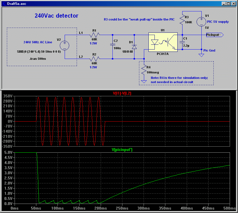

Here is about the simplest opto-coupler circuit that won't burn up or kill you... and doesn't use huge capacitors. C2 can be a small disc ceramic.
It detects the turn-on of the AC almost immediately, but it takes it a while to realize that the AC turned-off. R3 could be the "weak-pull-up" inside the PIC. Note that the input resistors are half Watt. It is active-low at the PIC input.

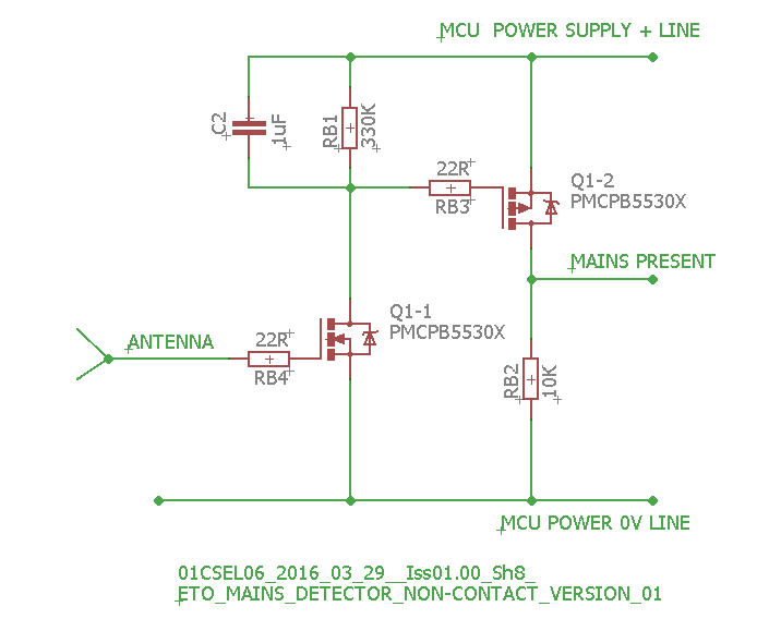

Here is a circuit that relies on the electromagnetic coupling to a wire placed near the mains cable required to me monitored.
