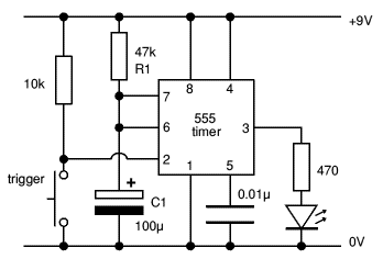

I hope someone can help me with this project.
I need a very small switch device, no bigger than about 15 mm in diameter and up to say 25 mm thick, and powered by a small watch battery. The device would have one main function - when you press the switch, a light (say LED) flashes, at say 1 to 2 sec intervals for around 30 mins, then goes off. That's it. It would also be nice if it had a battery low function so that the LED would say flicker continuously for say 15 seconds if the battery was below a certain useable level.

What you need are 2 different timers, both can be 555 timers or they can be a single 556 timer (just two 555s in one package). One needs to be monostable (it only triggers once) and one needs to be astable (triggers repeatedly).
Here is the schematic for a monostable 555:

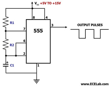

The output of the monostable (pin 3) would trigger the astable 555 on pin 4 (the reset pin). When pin 4 on the 555 is held low the output will be low so the LED will not blink. Here is the schematic for an astable 555 timer:
All you need to do is to calculate the values for the RC network. Luckily this website has a tool that can tell you what frequency the output of the 555 will be based on the values you used, the catch is that it only works for the 555 in astable mode. For monostable mode you will need to figure the values out for yourself. The amount of time will be 1.1 x R x C, you can also flip this around to solve for R or C based on time. t (in seconds) / 1.1 / R or C.
At longer time constants the reliability of the 555 becomes severly compromised, 30 minutes is pushing that limit quite hard. You may need to use a counter, something like a 4017 could count 10 inputs, if each input lasts only 3 minutes (3 minutes is a much better time constant for the 555) then you end up with 30 minutes out. The only thing with that is that while the 4017 is set to trigger the astable mode, it needs a way to either retrigger the monostable 555 or the 3 minute timer would need to be a 3 minute astable timer that is disabled when the other astable 555 is disabled.
