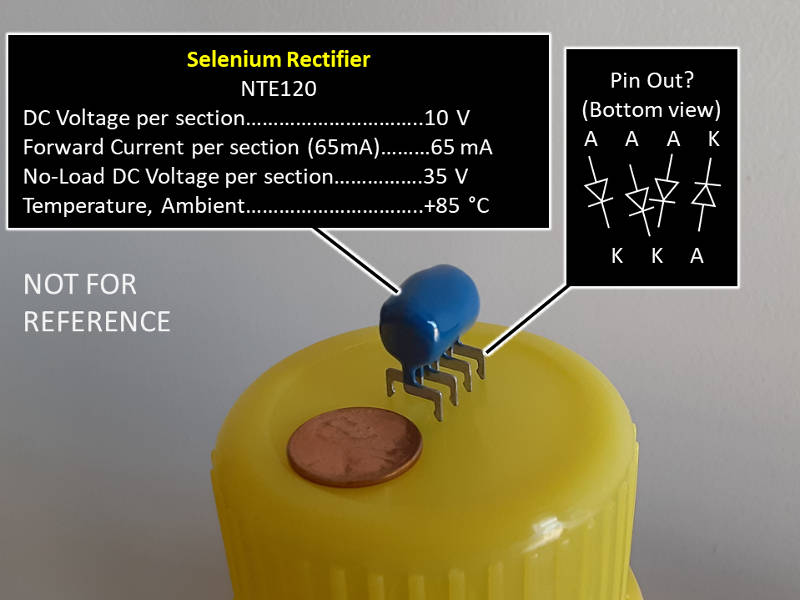

I recently purchased a few selenium rectifiers. The few technical resources I could find about them say they were mostly used in high-voltage systems like voltage multipliers for cathode ray tube (CRT) television, railroad signaling, etc. A few that are still commercially available today have working reverse voltage ratings well over 5 kV.
I also found some very small selenium rectifiers (see the attached image). These seem to have much smaller voltages in mind. There is not a lot of information about where these are used or if they excel at anything in particular. After characterizing one sample with a multi-meter, it looks like this contains 4 rectifiers. Two of them share a single cathode (K) pin, the other two rectifiers are independent. There's not a whole lot of information on the web about it...just a few mechanical drawings, plus the statistics I included to the photograph.
Does anyone know how this style of miniature selenium rectifier is being used? I've included a U.S. penny for scale...

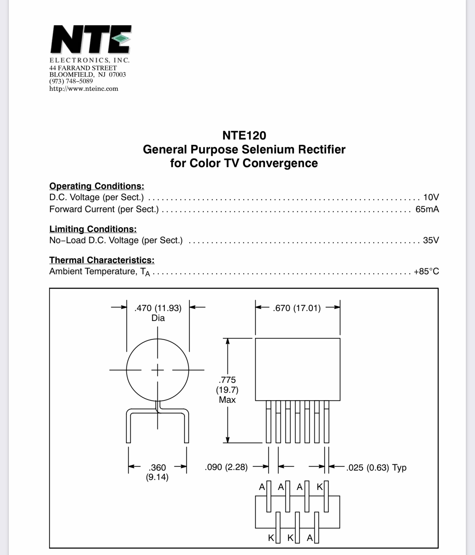

According to the datasheet...
That was back when every colour TV had that huge glass tube with 20Kv+ anode and setting up convergence was 'Fun' :rolleyes:

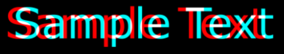

Okay. I forgot to mention, the original packaging did mention TV color convergence. It sounds like color convergence was meant to get the CRT beams for red, green, and blue images to align properly. To avoid something like this...
If this is true, then were selenium diodes better suited than other diodes for this type of use?

Presumably so - however, I've repaired thousands of colour TV's, and wasn't even aware that selenium diodes were used - so they obviously never failed in that situation.
As for convergence you had both static and dynamic convergence to set up, as well as purity - it was really a pain until PIL tubes arrived.
Just because these diodes were used in TVs does not say they were commonly used. ( or used in the last 40 years ) I used silicon.
Well 'nothing' was used in the last 40 years, as convergence adjustment was gone by then :D - except for Sony Trinitron who never went PIL, but they were in-line and didn't have the masses of adjustments of the original delta tubes.
Anyway, as for the original question - find a bin and throw them in!.
Since I have them I figure I'll at least characterize them and see how they perform versus silicon. These aren't the type of high-voltage selenium rectifiers I'm used to reading about and they are apparently effective at low voltages.
I'm actually having a hard time finding TV schematics that might hint at the exact circuit role these would have had. I did find one U.S. patent from 1969 that looks promising. It has a color convergence (sub) circuit that uses exactly 4 diodes, and 2 of them have connected cathodes just like this sample. I'll give it a closer look later this week. If anyone's interested, its US3631296A.
Selenium diodes have a nice acrid odor when they blow. They also have a much higher voltage drop than silicon.
