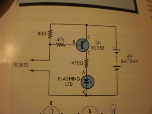

Small relay and transistor circuit trigger at <1v
You might find a transistor that can stand 30 mA base current.
Or find a germanium transistor.
Another way may be to shunt the silicon b-e junction with a silicon diode and a small series resistor.
This diode will steal some current from the base at Vbe > 0.5v and you can adjust the diode series resistor to have the base current close to the abs. max. rating.
Any common transistor can handle 30mA base current. Audioguru and I suggested adding 47Ω in series, mostly for insurance. The diode is unnecessary.

How about using a comparator (like a LM339) to detect the 1V signal? The comparator can drive a transistor which in turn drives the relay.

Ok, so far, all I've seen is a lot of guessing about what will work for the OP. Let's do a bit of math to figure it all out.
The OP says that he has 1 volt at 30 ma available when he wants the relay to turn on. Let's just look at a typical low power transistor datasheet. Let's start with the venerable 2N2222A. It's available from many distributors such as Mouser and Digikey.
The datasheet says that it can handle 600ma of collector cuurrent. Typical 5V relays of this nature have a coil resistance of 160 - 200 ohms. So, the collector current the transistor will have to handle is roughly 30ma or less. Not a problem for our transistor.
Now. we need to figure out how much current the base needs in order to switch the transistor into saturation. Typical Vbe for a silicon transistor at turnon will be about 0.65 volts. So, if we have 1V to drive it with, we know that we have adequate voltage to turn the base-emitter junction on (1V > 0.65V).
Now, how much current will we need into the base? From the datasheet, we see that with a collector current of about 30ma, the transistor has a DC current gain (Hfe) of about 100. That means that if we need a collector current of 30ma, the base current will have to be .03ma/100 = .0003ma, or 300ua. The base-emitter voltage is 0.65, so the voltage that the resistor needs to drop is 1-0.65 = 0.35V. So, the base limiting resistor will need to be approx 0.35V/0.3ma, or 1.2K. The 100K resistor is there to prevent collector-base leakage current from turning the transistor on.
Now, we know that the 1V input can turn our transistor on with enough gain to energize the relay. The only thing remaining is to latch the relay. See the diagram below for that. The OP will have to get a double-pole relay in order to latch it on. Otherwise, we would have to build a bistable latch (flip-flop) in order for it to work. Simpler to get the appropriate relay.
Absolutely not.
The datasheet for the 2N2222A shows that its hFE is 100 only when it is not saturated with a collector voltage of 10V. But as a switch the transistor must saturate with a collector voltage of 0.1V or 0.2V. When the transistor is saturated the datasheet says that the base current must be 1/10th the collector current.
