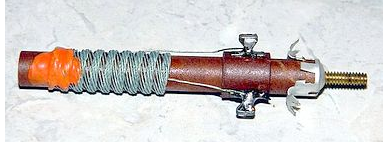

Here is a picture of "scatter wound". It is a way of adding space between the wires and allowing the part to work at a higher frequency. I have also added transformer tape between layers of wire to increase the ability to work at high frequency. Both methods do not make the windings smaller.
One thing not mentioned so far and will be one of the biggest issues is driving the fets, or whatever switching devices, driving the gate charge at 1mc will take a fair amount.
Ron that looks suspiciously like an old tube radio oscillator coil.
