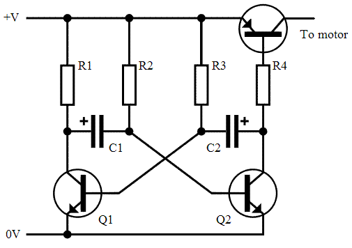

An astable multivibrator with a booster transistor will work.
The resistor values will depend on the frequency, duty cycle and current required by the motor.

The values listed in Wikipedia are only good for about 0.5Hz and even with the booster transistor the maximum current will be too small for a motor, 3mA.
  • R1, R4 = 10K
  • R2, R3 = 150K
  • C1, C2 = 10μF
For a 150mA motor divide the resistor values by 50 and multiply the capacitor values by 50.

I posted a circuit which should do what you want, the following component values should work.
  • R1, R4 = 180R
  • R2, R3 = 2k7
  • C1, C2 = 470μF
Here it is again.
astable-muti-gif.26216
