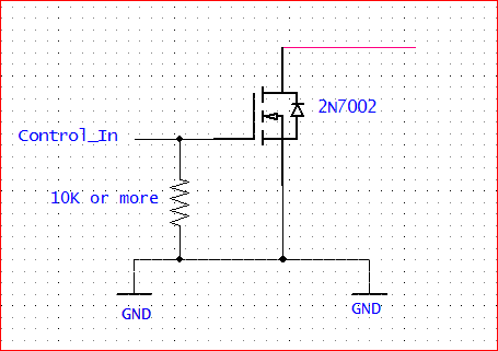

We need to be able to simulate this button press instead with software from a Beaglebone Black, which runs at 3.3V. My idea is:
GPIO from Beaglebone into an N-Channel MOSFET Gate.
Power On/Off line from switch into Drain.
GND into Source.
Then when software turns that GPIO pin high, it will simulate a button press until it is turned low. Anything I am missing here? If not can someone help me spec out a MOSFET from digikey/mouser/Newark? The beaglebone again is 3.3V, and the Modem line 2.6V.

In the second case, I think the 1.2V might be the forward voltage of the LED in the optical relay.
If that's the case, you just need to limit the the current to whatever the datasheet decrees: a series resistor
Awesome thank you.
The 10K is a pull down correct? It keeps the Control In, my GPIO pin, at LOW instead of possibly floating, until I tell the software to set it HIGH?
I'll check my datasheet for the solid state relay. If you it would be a series resistor in-line with the Control Input of the solid state relay correct? The one I'm using has 6 pins. Control +, Control -, then two pins for a NC set of contact and two pins for a NO set of contact. I think I know how to figure out what resistor I need but it would similar to LEDs so in the range of 100-1000 ohms or so?

Limit the drive current enough that the relay operates at all conditions you expect.
Frinstance, a 3.3V supply would give 20mA through a 1.2V diode with a
(3.3 - 1.2) / .02 = 105 ohm resistor
