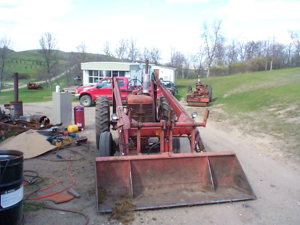

I was cleaning horse corals today at my dads when I had an equipment failure of rather surprising results with his tractor!
I am not one that gets shocked or surprised by much of anything but this had me wound up for a bit. :mad:
The right side main pivot point for the whole loader system violently failed.
I had a full load of manure in it, about 1200 pounds, and was about 5 feet up when it broke! Another two feet higher and I think it could have possibley tipped the tractor over.:eek:
When it tore out it swung the bucket and loader frame over to the left so hard it lifted the rear tire off the ground. The rear wheels are weighted and have solution in them to give it about an extra 1200 pounds per rear wheel.

Hence all of the welds and plating that has been added the loader frame over the last 20 years.:eek:
Well now its getting a new frame made up this next week or so! ;)

I notice a little bit of welding has taken place there.. Classic metal fatige. Should teach him a lesson, probably not, glad no one was hurt.
If you patch something like this the important lesson to learn is cut away the failure point and double up on material for the patch, and nice beads. What I see there isn't a weld, so much as it is metal filling with welding which is GREAT for short term strength and horrible for brittleness.

If the failure was actually due to fatigue, there will fine parallel lines along the fracture edge where the tear started. These are called 'beach marks'.
A magnifying glass ought to bring them out, if they are there.
If the failure was just due to a single overload event, probably starting out at some sort of stress concentrator such as a corner, or maybe a crack within a brittle weld, then the edge of the break will not have any definite pattern to it.
It is sometimes useful to try to determine where the break line actually started, and where it terminated... as far as strengthening any repairs.
Looking at the third picture, over by the weld line, to the left of the picture,
there is one interesting spot that is just right of the weld metal line, where that top front 90 degree angle is. Note that 90 angles are stress concentrators.... This is why those liberty ships used to come apart at sea during WWII... Maybe there was more than one application of weld metal in this region of the original piece.
Typically, weld metal is stronger and tougher than the base metal. It may be that the heat incurred when that left top weld line was done caused some sort of carbon migration to occur. There would be some spots with excess carbon, and others with not enough carbon, causing some micro-regions with excess carbon to be brittle, and others with insufficient carbon to be weak, and leading to general weakness in the original base metal at that particular point.
One repair strategy would to repair original structure as best as possible, and then to put 'lap plates' on the top and sides, to lower the stress in the weld seam.

My welds dont fail. The original metal next to it does.:)
The loader is heavily used and about 25 years past its 20 year life expectancy. It's just old and worn out.:eek:
The metal has noticeable deep corrosion and too many stress cracks to count. I would have rebuilt it 10 years ago but I am not the owner. :mad:
So all it gets is band aid fixes an root of the problem just gets ignored. AGE! :mad:
The only reason its getting a new rebuild is because this time the frame got twisted far enough I cant straiten it. Other wise yesterdays band aid fix would probably still be there 5 years from now. :mad:
