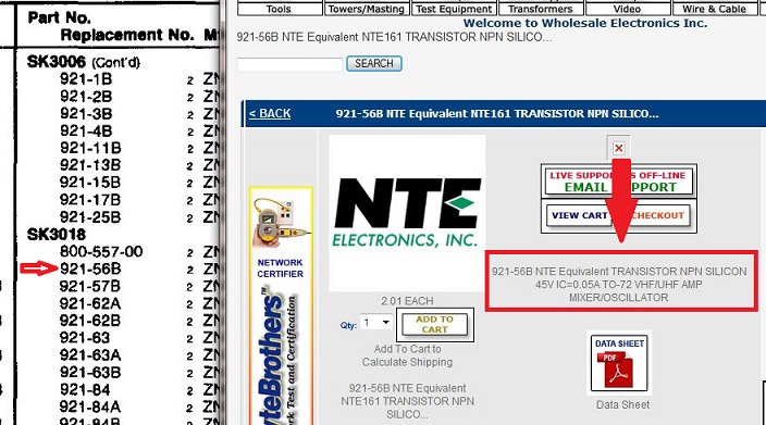

I know someone with a early 60's plymouth, I tried to repair the mopar am/fm radio a while back, the mixer osc transistor is dead, but its a sk3018 4 pin to18 type metal can device.
I tried a couple of alternatives, but with it being germanium and used as a mixer/osc is difficult to replace.
Any ideas on what I could do to sort this old radio out, being the original my mate wants to keep it.

Maybe:
Claims to be suitable sub... NPN mixer.
Might need sheilding. And more drive.

Is it NPN or PNP?, the NTE list above suggests NPN, but from previous experience here it's not very often right :D
The ones I mentioned above were PNP, as most germanium transistors were.
The schem shows an npn.

Are you sure it's germanium? - the 1970 Mullard Data Book shows no NPN germanium RF transistors at all - and I don't recall ever seeing one?.
I think of i look hard enough I have some ac127's, ones in a little ally block with a bolthole, though it may take too long to find, I also might have a couple of ocxx devices somewhere the ones with the black painted clear platic case, the ones you used to scrape the paint off and use as light sensors as a kid.
The AC127 is audio only, no ft listed for it, but the later AC187 lists an ft of only 5MHz.
There are numerous NPN silicon RF transistors listed back then though.

SK 3018 Mopar Auto Radio
1. SK3018 is an NPN high frequency SILICON transistor.
2. It crosses to an NTE/ECG 316 which is readily available.
3. That SK3018 is not original to that MoPar radio --someone has replaced it previously.
Good luck with it.
I cannot get the nte either, tried that at the time.
All the devices in the set as sk3018, except the o/p devices and they are shown on the parts list on the drawing I have.
