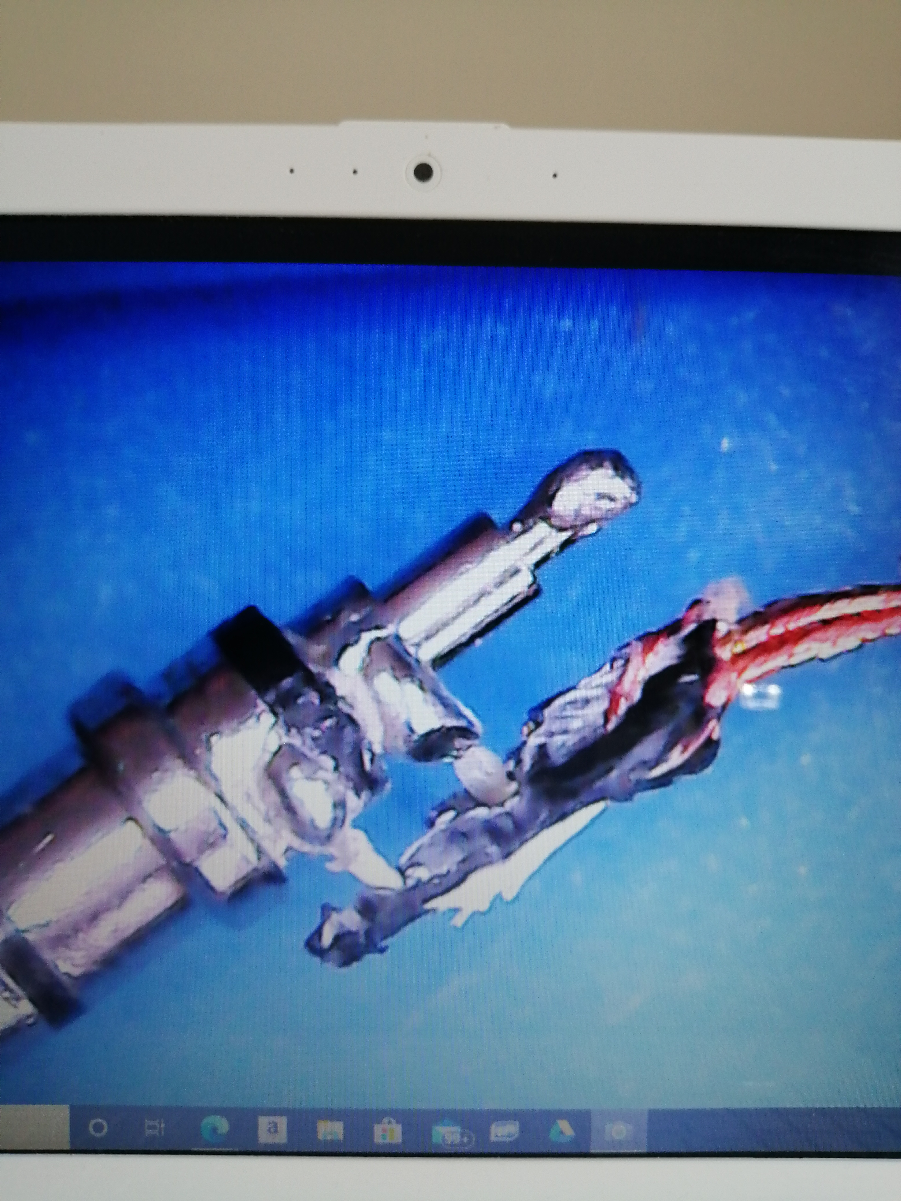

- image (TRRS jack) you can just about see the white (MIC) wire is connect the the Sleeve, however the other wire attached I cant work out because it is moulded in with the black plastic.

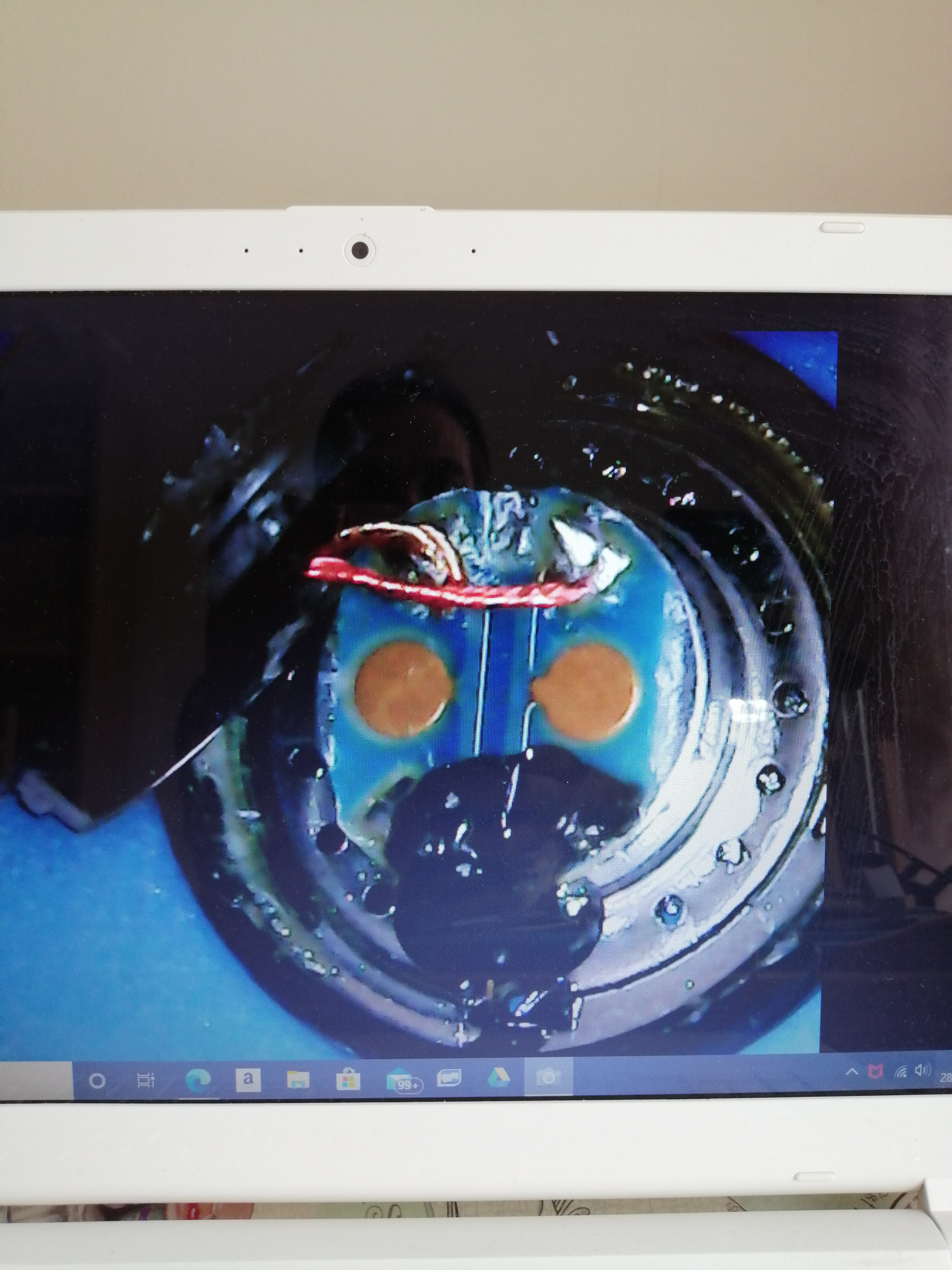

- image (Single earbud) you can just work out that the wires used are solid Red, and solid Copper.

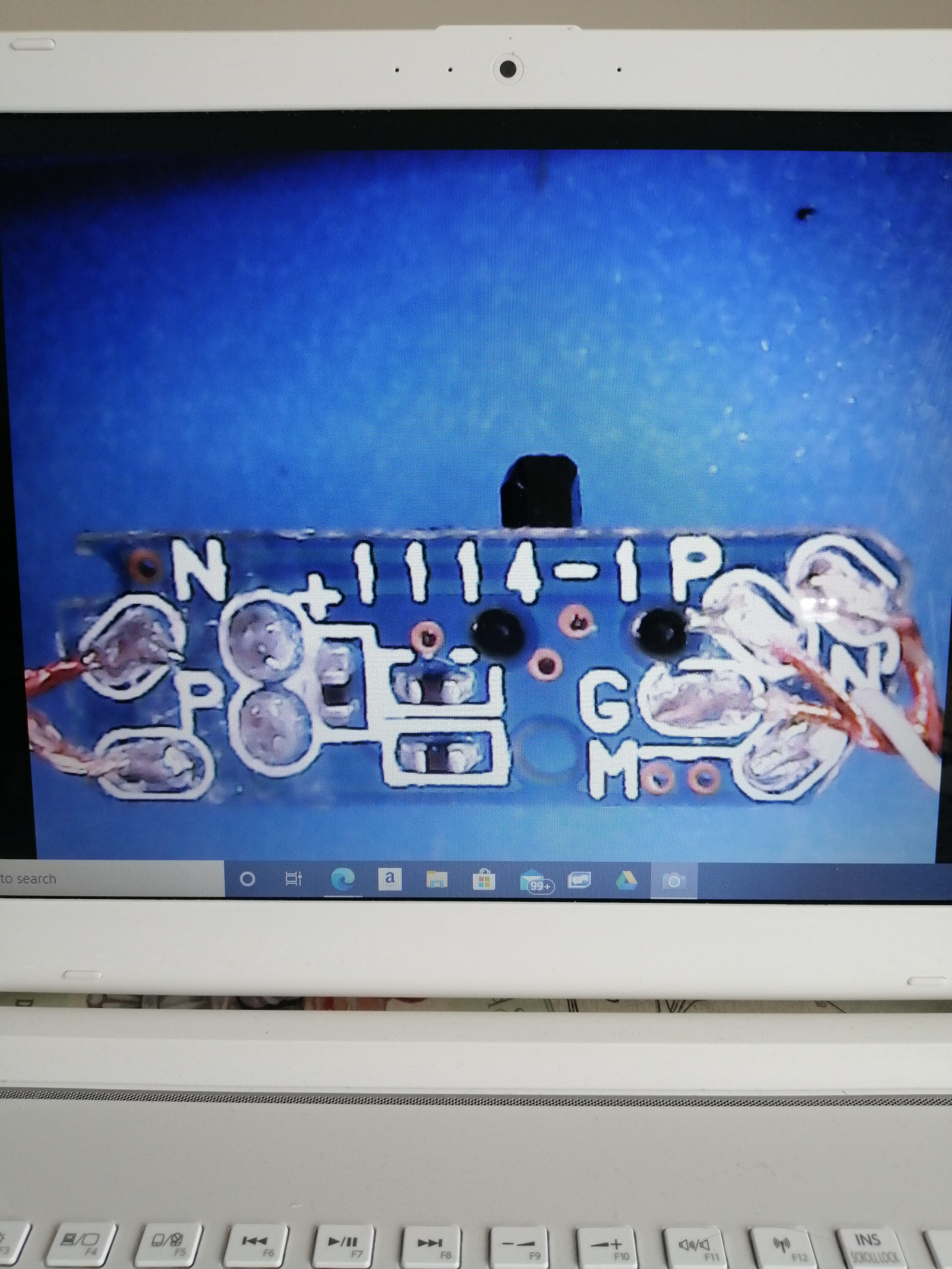

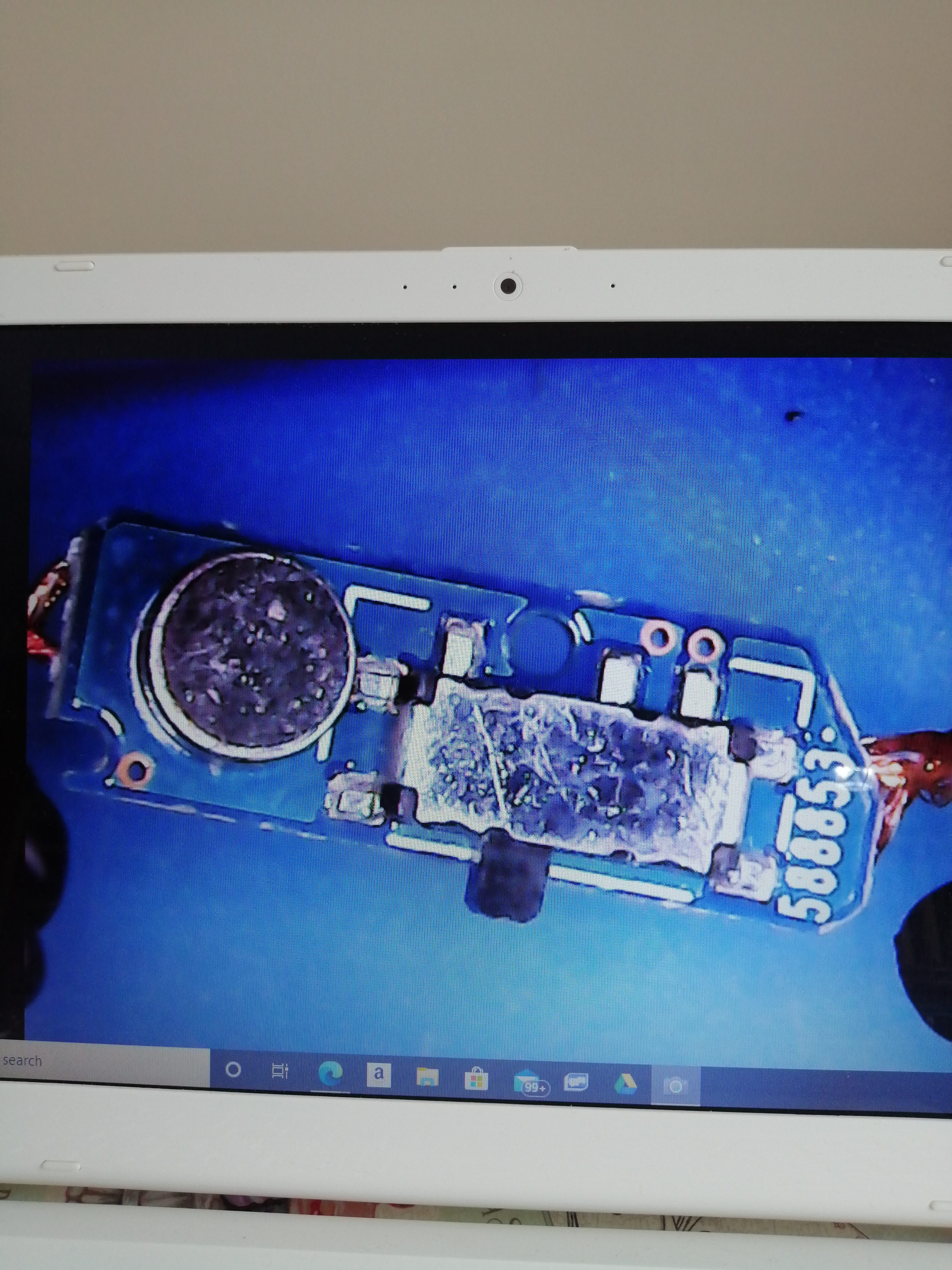

- image (Front of PCB Mic slide switch) you can see the slide switch and the Mic.
- image (Back of PCB Mic slide switch) you can just work out the wires as I previously mentioned above and the 3 SMD components used.

It appears the earpiece was using the tip contact before, so I'd put it back on that; the plug pin is already tinned so soldering would be easier.
I'd expect earpiece ground/negative and mic ground to both go to the second ring contact, the one that still has something on it at the plug.
The separate wires from the headset minimise crosstalk between the headphone and microphone sides of the system.
That "other wire molded into the black" may not be a wire. Some thin wire assemblies have a piece of glass fiber or nylon fiber (yarn) to add both:
- tensile strength to the cable, and,
- by pulling on this Will rip open the outer jacket without damaging the inner wire insulation.
