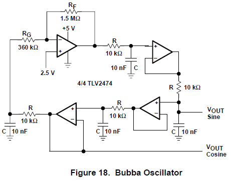

If I remember correctly a bubba oscillator produces very accurate sine waves. You can build it with most quad-pack opamps.
Texas Instruments has an article about sine-wave generators.
Their Bubba oscillator uses four lowpass filters and all need to be changed to change the frequency. It does not have a circuit to limit the output so the first opamp clips a little. The distortion after the first lowpass filter at the Sine Out is pretty bad at 1.1% and at Cosine Out the distortion is 0.1%.
A Phase-shilt oscillator works almost the same and needs "only" 3 filters to be changed to change the frequency. A Wein Bridge oscillator must have a circuit added to limit the level for low distortion and needs only 2 filters to be changed to change the frequency.
