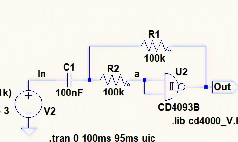

Here's the simulation of Ron's basic circuit in post #4 with a CD4093 model:
Note the interesting thing about this circuit is that, after the initial transient (not shown), the output has a 50% duty-cycle independent of the input amplitude.
That's because the only stable condition with the capacitor coupling is where the average current through R1 is zero.
That occurs when the input level at node "a" is where the average DC output is 1/2 Vdd or 50% duty-cycle.
If the output is not 50% then the average current through R1 is not zero, causing the node "a" DC bias to change until 50% is reached.
This is also independent of the CD4093 input transition voltage.
Basically it has negative feedback adjusting the bias point to cause a 50% duty-cycle output.

Those two schematics shown above (posts #4 and #6) are not reliable.
The first (#4) is a high-gain amplifier, that will amplify any noise on the input if used with non-schmitt-trigger inverter, and will oscillate if used with schmitt-trigger inverter (when the input signal frequency becomes low). The second (#6) will oscillate when input frequency is low.
If this is for displaying the encoder count, as mentioned in the link in #10, then the best solution would be to use a microcontroller. The shifted quadrature signal could be read directly by four ADC channels.
You are wrong about post #4. That is not a high gain amplifier. It is an inverter with properties that may be specified but not shown on the schematic. It is one of the special devices in LTspice. You would know this if you were familiar with that piece of software. There was never a claim for this circuit that it was realizable in practice.
As for the operation at low frequency, a lower limit was never mentioned as a requirement in the original post by the TS. The TS might want to amend his query if there is such a requirement.
Because bob4bvm has not come back/responded to "DC" questions, I am going to stop guessing on what is needed.
I lied, one more try. Because I was not clear that "~ 4Vp-p sine" is, I tried to make a circuit that finds the center of the waveform. If the circuit really needs to go to DC, then we need a reference voltage that indicates where zero is. Then the answer is clear.
Compare circuit #4 & #6. The difference is R2. I would choose 1k or something to limit the inrush current. I was relying on the input perfection diodes to help box-in the ac coupled signal. (SPICE might not have the diodes, did not check) With a (low value of R2 and protection diodes) the signal should very quickly move so it is boxed-in by -0.7 to +5.7V. Then at a slower rate the RC time constant moves the center of the waveform to 1/2 supply.

Now set the input frequency to <50Hz. You have formed a schmitt-trigger oscillator.

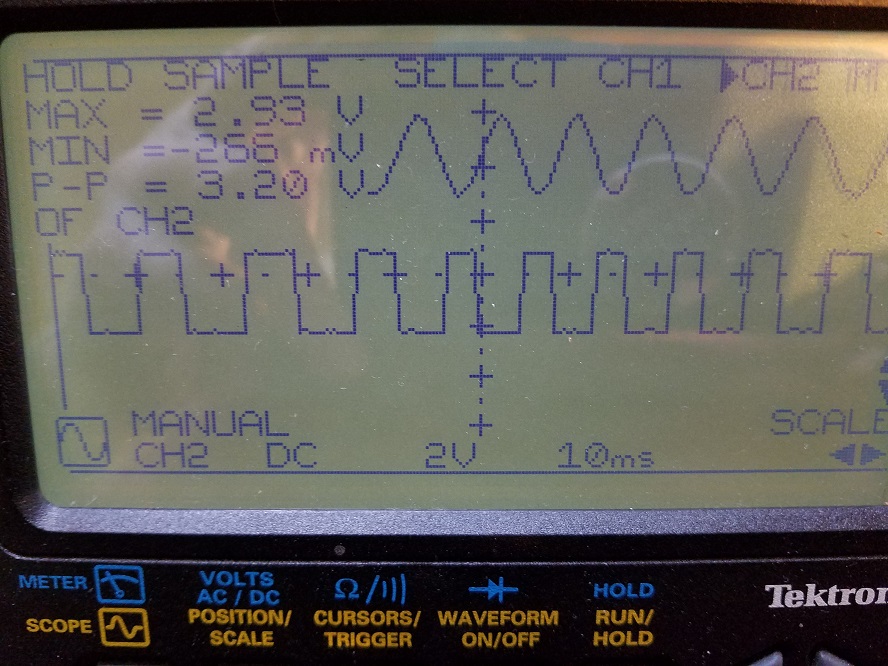

I had fine success using Crutschow's ckt
For some reason, using the input cap, i got a nice triangle wave output.
Deleting the cap gave me a decent square useable for my purposes.
Sorry i did not give enough detail.
This is pretty non-critical. The encoders are sine output, so i just wanted to square up the edges a bit to give the uC a nice edge to count. This ckt makes the count alot more reliable at the low frequencies i am using.
The project is for telescope position sensing, so nothing is moving all that fast.
Cheers
Bob
Here is the result:
