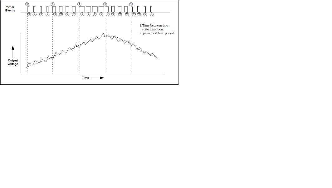

ya, its not d2a, but your interpretation sounds correct regarding 8 bit...however how can we say it is providing 120 degree phase shift?
I am not able to understand how to interpret equation 4 given in the datasheet??
timer reload value= [FFFFh- ({Fosc/4}/sine samples per cycle *ADC)]
I am not getting the logic behind this....

Look at this image, it explains 120deg offset.
Is this what you mean.?

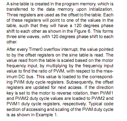

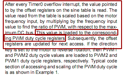

Its all explained in the last image I posted.
I have extracted the details in this image.

After every Timer0 overflow interrupt, the value pointed
to by the offset registers on the sine table is read. The
value read from the table is scaled based on the motor
frequency input,
by multiplying by the frequency input
value to find the ratio of PWM, with respect to the maximum
DC bus. This value is loaded to the corresponding
PWM duty cycle registers.

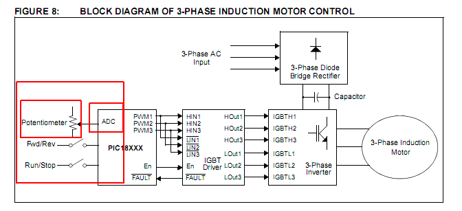

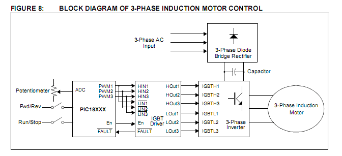

what is other input???Is that ADC value???
Its in datasheet and my earlier image, its the output from a speed pot thats digitised by the PIC adc input, giving a 10bit resolution value.
