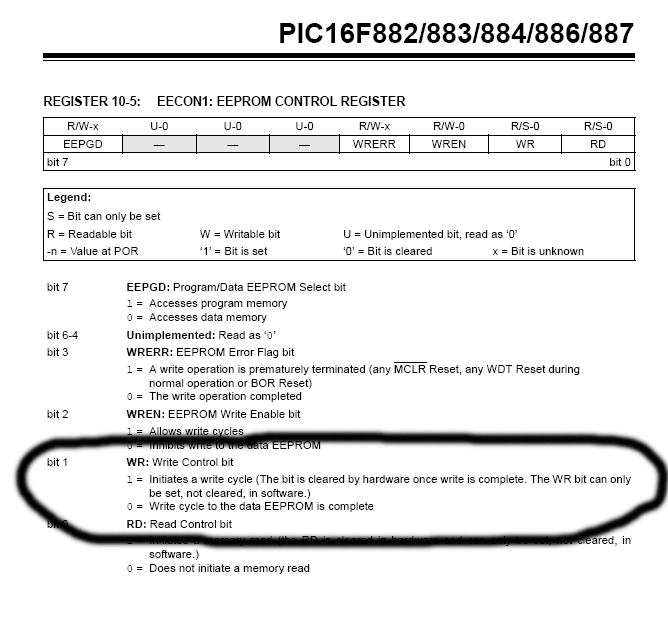

I am troubleshooting a program using MPLAB Simulator. In the code, I am learning to work with EEPROM by writting data to it and then trying to read from it. When writting data to EEPROM, the write control bit of EECON1 correctly sets. However, it does not clear after the information is written. The 16F690 datasheet says it is cleared by hardware. Can a set Write Control Bit of EECON1 clear while using the MPLAB Simulator. If so, how?

But in modern PIC's like 16F886 it still does not clear.You have to poll the EEIF bit for a write complete.
Great help. Polling the EEIF bit works in the MPLAB Simulator. I can now troubleshoot writes and reads in EEPROM.
Not according to the data sheet.

Mike I tried that WR bit in real life.But it never gets clear.So I poll the EEIF bit as shown in the 886 data sheet.
I think this shed some light in here
Interrupt flag bit EEIF
The user can either
enable this interrupt or poll this bit. EEIF must be
cleared by software.
Just tried this and the WR bit does get cleared in the simulator.

Edit, it will not work if you single step through the code as the required sequence doesn't get followed.
