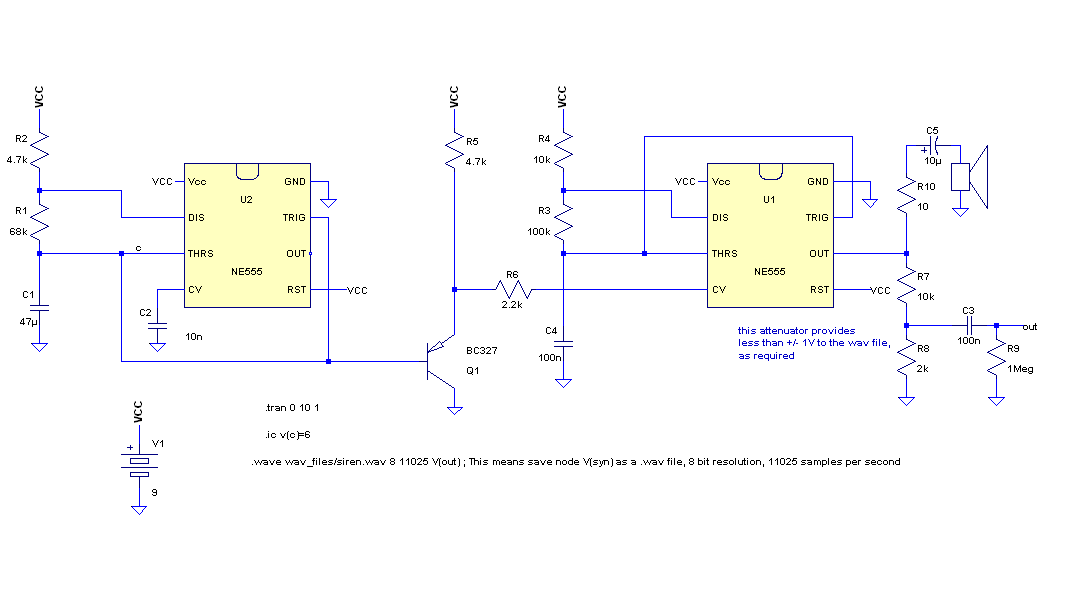

OK, here's a sim of your circuit in LTspice. It creates siren.WAV in C:\program files\LTC\SWCADIII\WAV_files. You will probably have to create this folder before the sim will run.
Below is the schematic and 555 siren wav.asc, which will run in LTspice if you copy it into C:\program files\LTC\SWCADIII before you open LTspice.
It doesn't sound much like a siren, but you can probably modify the circuit to make it sound better.
  • 555 siren wav.asc

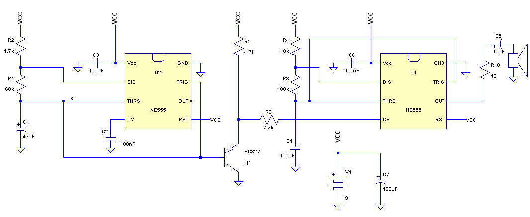

In response to a PM question from Rumieus about the circuit I posted:
I actually don't know much about the WAV format, but I'm fairly certain that the signal amplitude in WAV files can be no more than ±1V, or clipping (distortion) will occur. R7, R8, R9, or C3 are in the circuit only to satisfy this requirement. Below is the circuit as it should actually be built.
