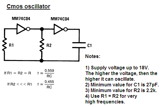

OK does anybody know of a substitute to the SSM-2018 chip that is a voltage controlled amplifier i think (VCA) i do not know hwre to start because i do not know of the frequenzies we r dealing with here. does anyone know where i can get the formulas to calculate the frequenzys of logic gate oscilators.
Cmos oscillator:
hm intersting but i was refering to the type of oscilators used in my diagram that have the capacitor from the inveter input to groung and the resistor from input to out all on one gate only.
thanks anyway for ur help
