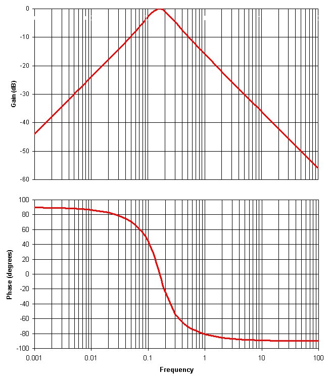

are you sure you understand what you are solving for here? I had no problems plotting either the gain or the phase. The plot makes complete sense - the zero is forcing the gain to increase at a rate of +20dB/decade until it hits the double pole at around 0.15 or 0.16 degrees (1 radian!) where it then decreases at -20dB/decade. The phase plot shows the double pole by shifting -180 degrees.

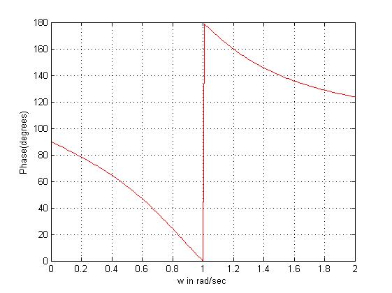

Phase/equation with arctan function
maybe i make an error in reasoning, i would be glad if u can correct me.
thx for ur comment.. i dont know for sure if my problem is clear for u my Problem was not to analyse the phase and amplitude curves, i just wanted to derive the phase equation without the computer..
i think outtolunch u used the bode function in matlab but if i plot just the phase equation directly [phase=90°-arctan(w/(1-w^2))] i get the plot a lil different (than the real phase like in ur attachment) which has a pole at 1 and shifts 180°.
If i use w greater 1 in the phaseequation the phase is not equal anymore with the true phase since the arctan function has a pole at 1.
thats why i said u must add 180° (shifting y) in order to get the right phase above w=1 and is only true for 90° to 0°.
Of course i could missed something here, ill be glad to be corrected or adviced.
